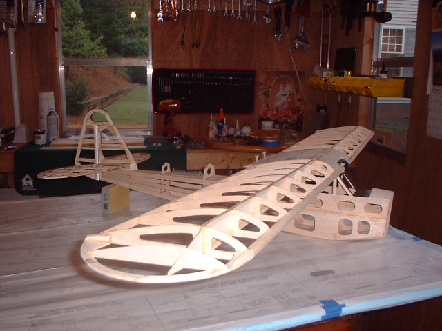

I'm building a GP electric Cub and the Plans
call for 3 degrees of + incidence with the Aft
deck at 0 degrees. This is on the Horizontal
Stab. I'm not sure how their measuring on
the plans? (L.E or T.E.) . I have ordered a
I. gauge, but it is not arrived yet.
This is my 3rd build after a 22 years of being
out of the Hobby, talk about changes. lol
Thanks in advance!
Bob

Thanks for the replys, here are the Specs of my Cub.
SPECS: Wingspan: 58.75" (1490mm)
Wing Area: 471.5 sq in (30.4 sq dm)
Wing Loading: 16-17oz/sq ft (49-52g/sq dm)
Fuselage Length: 37" (940mm)
Weight: 3.25-3.5lb (1470-1590g)
Airfoil: Flat-bottom, high-wing
Center of gravity: 2-7/8" back from the leading edge of wing at fuse.
(not from inside the windshield area)
Control Throws- High Rate Low Rate
Elevator: Up and Down 3/4" 5/8"
Ailerons: Up 1/2" Down 3/8" Up 3/8" Down 1/4"
Rudder: Left and Right 3/4" 1/2"
Note: If your radio does not have dual rates, we recommend setting
the throws between the low and high rate amount.
Incidence- Wing: +2°
Stabilizer: +3° with the aft deck base at 0°
Motor: 4° down thrust and 2° right thrust
Looking at the plans the LE of the H. Stab is higher than the TE.
I'm using a Protractor for the time being, but still don't see where
the +3 degrees is with the Aft deck at 0 degrees.
Still confused lol.
Bob

Be carefull with "datum lines"; You want the difference between the stab and the wing, with the wing leading edge higher than the trailing edge.

Old 08-29-2007 | 02:32 PM
skeeter_ca's Avatar
Joined: Nov 2005
Posts: 974
From: Yucaipa, CA
Default RE: Incidence setting ?
Jeez......... somethings can be made much harder than they are.
The aft deck is the large flat area between the wing and stab. They show a clear picture of it on page 27. It's where you glue formers f4a and f5a. Place a small level on this horizontal sheet (the aft deck). Shim up the tail of the plane until this area is level. When you get the incident meter place it on the horizontal stab (see included instructions on how) and shim the front of the stab up until it reads +3 degrees and glue it into place.
Walaaa!! done. All the hard figuring is done for you. Now get back to work!
Old 08-29-2007 | 02:43 PM
skeeter_ca's Avatar
Joined: Nov 2005
Posts: 974
From: Yucaipa, CA
I just took a better look at the instructions.
It looks like the stab saddle(the part you glue the stab to) will set the proper incident when the horizontal stab is glued down. If you look at the rear portion of the tail you will see the angle of the stab saddle is slight at a upward angle compared to the aft deck. So don't sweat it, just glue it down but make sure it's lined up straight as the instructions say.
Hope this helps. Sometimes the simple solution is the best solution.

Old 08-29-2007 | 05:42 PM
Joined: Oct 2005
Posts: 1,993
From: Deland, FL
Lol, I didn't think so lol.
Here's a pic , I hope.
Bob
