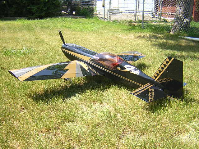

Saito 125. Flies my GP Extra with authority.
