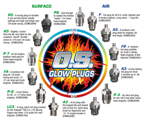

Old 09-06-2007 | 08:30 AM
Cyclic Hardover's Avatar
Joined: May 2002
Posts: 7,296
From: New Mexico,
Default RE: Glow Plugs
