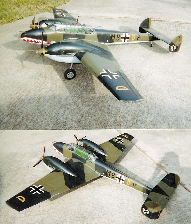

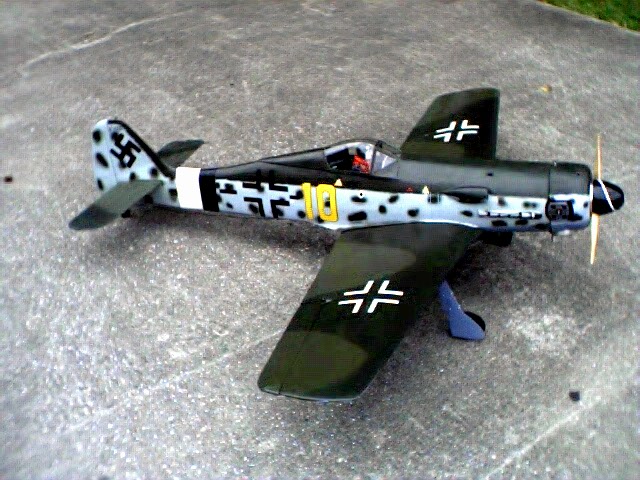

"Who use's dope anymore?"
I do. I'm an old timer and proud of it. I used Hobby Poxy and K&B Epoxy before I was an old timer.
"Now I glass all my planes because I'm doing Warbirds but I've done a ton of civilian planes with some film but mostly Solartex and 21st Century fabric. Then I prime and paint it."
Built a LOT of models but I seriously doubt I ever built a "ton" of them. I build on the heavy side, but not THAT heavy.
