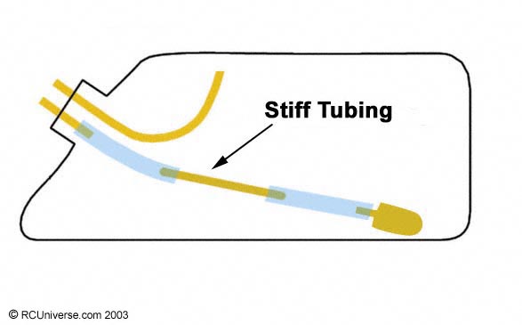

Here's my 2 cents. I don't like nose down storage for two reasons:
1) Like mentioned above, the clunk tubing will deform toward the front of the tank.
2) After run oil has a tendency to collect on the prop shaft making it easier for the nut to come loose.
Old 03-20-2003 | 04:14 PM
MinnFlyer's Avatar
Posts: 28,519
Received 9 Likes on 9 Posts
From: Willmar, MN
Default Storing plane nose down...
Here's a quick solution to the Clunk-to-the-front-of-the-Tank problem. Put a piece of brass or plastic tubing (some tank MFGR's supply the plastic tubing with the tanks (in the feed line INSIDE the tank). The clunk can still swing, but can't bend forward.
