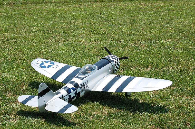

My P47 flies better with a MA 3blader than most 2bladers. The best 2blader MIGHT fly better than the 3, but would you fly a 2 instead of a 3 on that sucker?

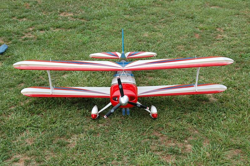

My Skybolt flies as well on a 12x6(3) as it does on the 2bladers that engine/airframe prefers. So I fly what I feel like flying that day. I have noticed that the 3blader MIGHT pull better on really hot summer days. I'm not sure that theory backs that up, but theory is just words on paper. How the airplane pulls verticals is right out in front of me, and the 3 seems to beat the 2. Go figure. Or go argue theory, I'm going flying.
