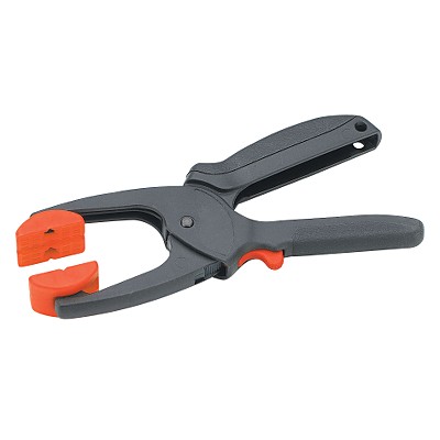

They are about 3" long, cost $1.99 each, and have a ratchet clamping action. They are perfect for holding down the leading edge of wing sheeting, and then I put some 2 1/2 lb plates on the wing to hold down the trailing edge. I highly recommend them.
