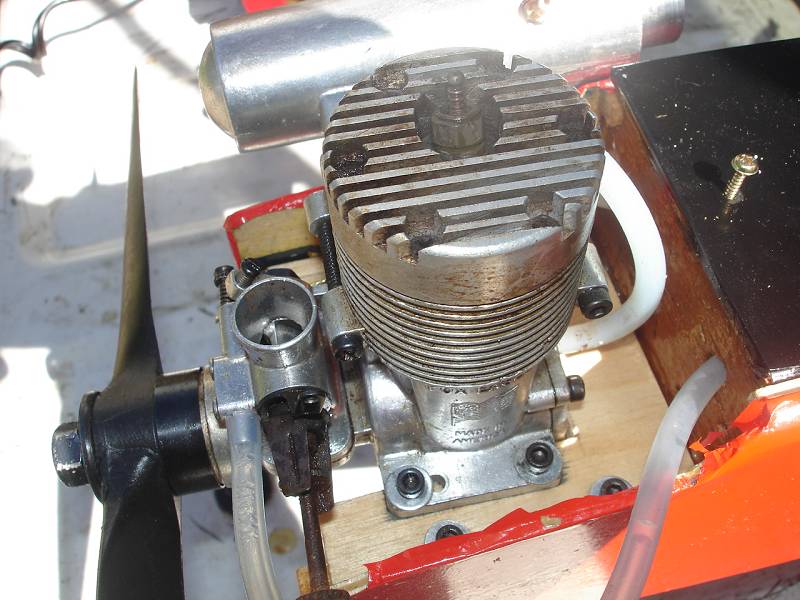

I have a probably quite old Fox Eagle 60 that runs very hot then slows down and finally quits. Runs good when it is cold. I have tried running it very rich but doesn't seem to make any difference. It still gets hot. I am using Sig 15% nitro all synthetic. It is becoming frustrating to say the least. Thanks for your help in advance.

most fox engines need 20-22 % oil also what size prop? 12 -6 or 11-7 are about the best.there were 4 versions of the eagle do you know which you have?

Don't know which engine it is. Here are a couple of pictures. Swinging a 11x7 master airscrew. 18% oil.

try a fuel with less nitro or a colder glow plug and a bit more oil .fox engines like castor oil.you can buy castor oil from sig and add it,if I remember correctly every oz of oil added to a gallon will increase the perecentage by aproximately 1% so about 4 oz of oil per gallon should give between 20-22 % oil.

The Fox's like castor oil and lots of it, at least 22%. 5% nitro is plenty.

If your engine crankcase is three peices plus the head it is an Eagle II or III. A two peice crancase plus the head it is an Eagle IV. If it is one of those reduce the nitro to 5%. I run 0 nitro one these with good success. If I put 15% omega blend it becomes a real cranky engine. I'll bet if you reduce the nitro you'll get a better running engine with better fuel economy with cheaper fuel.
By the way a one peice crankcase means it is an original Eagle. I do not know if the 0-5% nitro suggestion does any good with it. I do not have any experience.

Looks like it is a one piece plus the head. Does that sound correct.

What we found back in those Good old days was the carb could not be adjusted where it would stay where you adjusted it . The only thing a guy can do is get one of their newer carbs or check under the 2 screws in front and see if the low speed has some thing in it.. With that bypass fuel system it can change on it own[:@]

OMG the muffler is on inverted----------------------just kidding Looks normal to me.

Gee!! Bruce--I though the muffler opening was supposed to face the prop so it would act like a super-charger. Also it has a pressure nipple on the back plate as well as on the muffler. So I use the back plate one?
