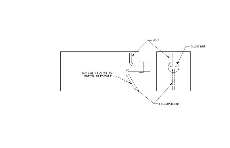

Old 09-19-2007 | 10:02 PM
  #59
linkadrip's Avatar
Joined: Mar 2006
Posts: 1,442
From: Tehachapi, CA
Default RE: How does a fuel tank work? help?
ok have a question on a tank setup on how it works. Well i realize there is a line for pressure and one for feed fuel to the carb. i have a lancair and it has to vent lines on the tank one feed line and a gas plane that is the same way. except of course the gas plane doesnt use a pressure tap for the tank fuel is drawn from the tank buy the vaccum of the carb.
But anyway on the lancair what is the second vent line for wish i could draw it. i think i will try may not be very good but may give an idea if it is visiable. should i cap this third vent line or is it for fueling the tank. thae lancair is a cmpro lancair not greatplanes.
on the gas plane the issue is fuel running out of the vent line i have one plugged and the other of course open to the air on the bottom of the plane but fuel tend to spill out of it. most likely a normal occurance.

Old 09-19-2007 | 10:08 PM
  #60
RCKen's Avatar
RCU Forum Manager/Admin
Posts: 28,257
Received 31 Likes on 27 Posts
From: Lawton, OK
The third line is a fill line. They are normally used on planes that have a closed in cowl when you don't have access to the pickup line to fill the tank. The fill line here is usually connected to a fueling valve, a fuel dot, or some other remote fueling setup. It is curved to the bottom of the tank so that you can pump the fuel back out of the tank.
Ken

It should also be noted that on a glow engine, that line needs to be plugged when the engine is running
Old 09-20-2007 | 08:22 AM
  #63
Joined: Sep 2006
Posts: 535
From: Racine, WI
This is how I do all of my tanks.
