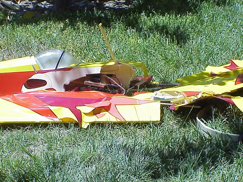

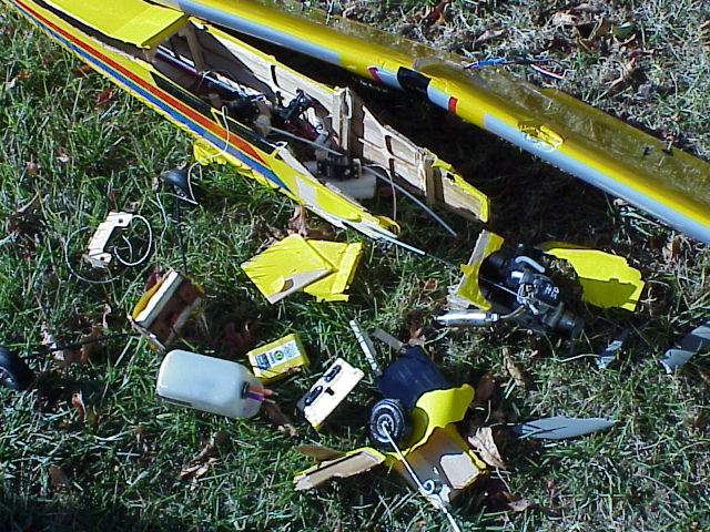

Four Vs two stroke is a pointless debate as their are rarely any clear cut winners.
However there is the simple fact that four strokes rarely survive crashes as well as two strokes. This one factor alone makes the use of a four stroke for someone brand new an exceedingly poor investment.
I realize the original poster is somewhere above that level However how far? I,ve no idea and only he can answer that question. So if you are comfortable with the fact that in many crashes your financial potential for loss is even greater then great go ahead and start the required new learning curve.
John

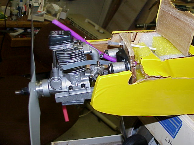

It's true, but the key phrase is "as well"
a 4-stroke has the two pushrod tubes right in front which are susceptible to damage in a crash. In the old days, they used to put them behind the cylinder, but that put the glow plug too close to the prop for most people's liking.
So it's true, a 4-stroke IS more likely to sustain damage in a BAD crash.
Simple remedy, don't crash

I see the guys at the field havine similuar crashes and bashing up the carb the intake port on their 2 strokes. Lets face it, a crash that is going to damage an engine doesn't care if it is a two stroke or a four stroke. The biggest difference in my mind is replacement cost if you do destroy an engine. The four stroke is going to cost you a bit more.
The first photo is the first time I damaged and engnie. The was the broken back plate. I had the plane repaired by the time the replacement back plate arrived. The next to are photos of the trainer after hitting a 2x6 board fence and the last is of my four star 60 after a full throttle nose first crash. In both of those totals, a quick cleanup of the engine and it was ready to go in the replacement plane.
I am biased to the four strokes. When I get it tuned, I fuel and fly, for days before I need to touch the needles again. I watch the 2 stroke guys and it every flight ritual to tweek and tune. Dead sticks are rare. I do have a couple planes with two strokes and they do have a place. Mainly flat out speed. Four strokes are what I like to fly though.
