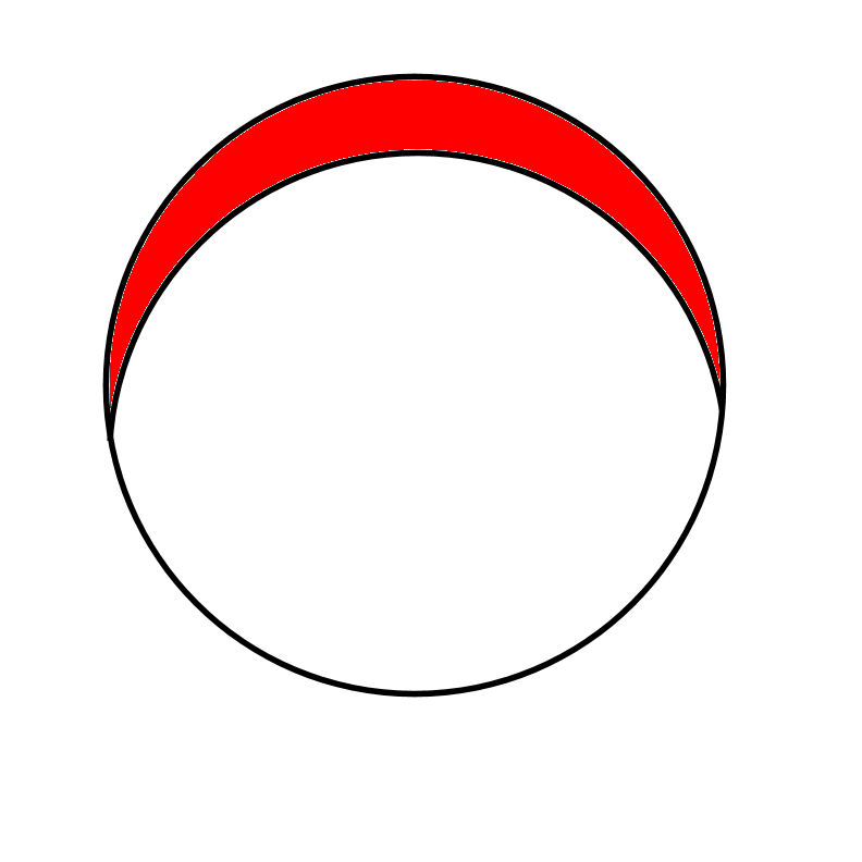

The problem described in the original response is a common misconception. The throttle servo has a linear response to the the transmitter, but if you closely examine the throttle system on the carb, you will notice that it is NOT a linear system. The circular shape of the air opening is by its very nature a non-linear system. The size of the inlet path has a very large change, percentage wise, at the beginning, as the throttle arm is moved. As it approaches fully open, the percentage change is very small. I could probably do some higher math to actually model how it changes, but suffice it to say, that its non linear. Consequently, you get the behavior that the engine seems to hit max RPM before the throttle is fully open. There is actually a small change as it gets to full throttle, but its generally beyond the capability of the average homo sapien to distinguish without some experience.

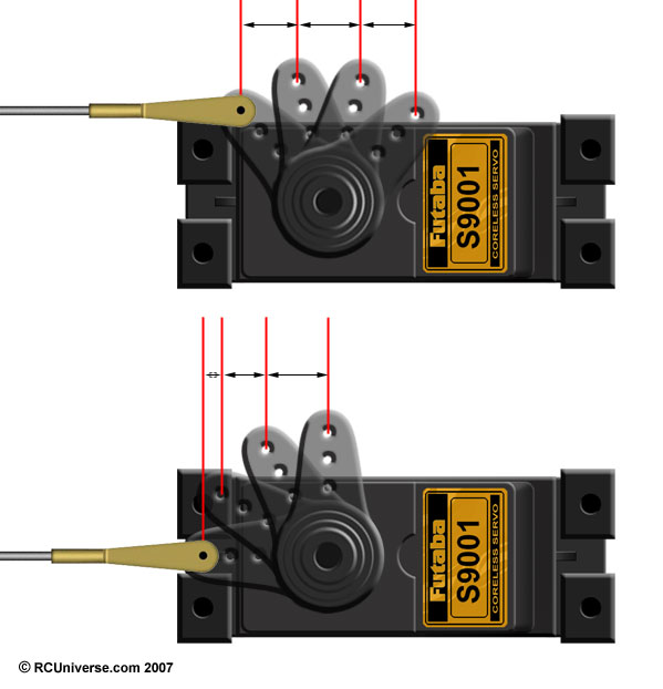

Here are a couple of pictures made up for this same topic awhile back. They basically illustrate his point.
The red area is how much the same movement creates in the carb. Couple of degrees up from low motor in the picture showing a tiny bit of red. And the same amount from WOT.
The movement of a servo however is from a rotation to linear, and at either end of the servo movement, the fore/aft is less for the angular change. You can do a lot to reduce this "softening" by making servo arm connection long so that the servo doesn't go full rotation to get full carb movement.
