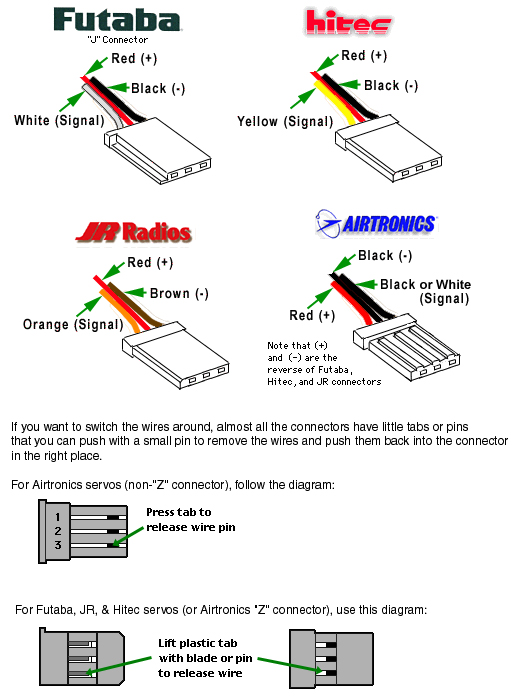

See attached diagram for wiring of different brand servos.
Ken

Mr. RC Ken fix that diagram please was going to print it off but it is to distorted. M>R your sure right about the help on here. Mr Ken is great as is so many of the guys. I also thank them for there insight. And so many good questions are asked also. Such as yourn here.

what's wrong with the diagram???? did you click on it to enlarge it??
Ken
Old 09-27-2007 | 06:06 AM
Joined: Nov 2004
Posts: 11,703
From: Memphis, TN
Default RE: Servo's for Ailerons
Diagram is fine, just printed a copy of the enlarged version. I did use a Laser Jet instead of an Ink Jet if that makes a difference.
