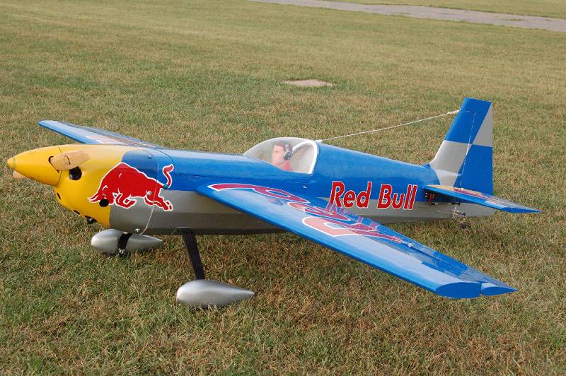

Looking at the cover of Model Aviation October 2007 and wonder how do they get covering like that. I am bascially a scratch builder and I can cover pretty good, but I can't compete with that . I would really like to see that done [8D].

In one word... Practice.
Those older guys have been covering since they were teenagers. You'll get there in no time.
By the way, you are looking at the COVER of MA. That's where the best of the best go. Don't try to compare yourself to that yet.

Actually you could do that just like they do. Go to a sign shop that does vinyl, which most of them do nowadays. And have 'em run you off some templates if they don't have machines that do Monokote. Give them the measurements and a plan. They do the hard part.
Then you clean off the dining room floor and take 30 or 40 rolls of Monokote and have at it.
Iron on ain't so hard. Have you ever seen one of the Control Line Precision Aerobatics models that have even more intricate designs? They're painted. And have to not only be gorgeous but light. And light really matters. Really. And the Goodyear Pylon racers of some years back looked as good. Actually often looked better on average because they actually didn't have the weight problem as bad.
But that big sucker does look good doesn't it. Iron on or not.

I would say that covering job is actually a graphics kit custom made for that plane. The plane probably started out blue and white and then decals were applied. Just my .02

You can go to a local sign company that cuts vinyl graphics and give them a sheet of covering (along with the design you want) and they will cut it for you.

Joined: Apr 2003
Posts: 712
From: Dunlap, IL
Default RE: How do they do that????
Here is a D&L Designs 80" Edge that I built from a short kit. I found the Red Bull logo online (I asked Red Bull, but they said they couldn't give it to me). My wife has a computerized paper cutter. I used its software to trace the outline of the figure and letters. I cut out cardstock templates that I traced on to Monokote. I resized the bull and lettering for the different spots (easy to do in the computer). I used the TLAR method to size them based on photos from airliners.net.
I think it came out pretty good.
Kerry

I got $20 says it's not painted. Almost always, when someone nowadays has the skill to paint, they use a gun or airbrush, and will almost surely do some fade somewhere. And does anybody glass something that large nowadays? For that matter, any size?
As for how large the airplane is? If you got the magazine cover, open it and read the writeup. The magazine says it's a 40%.
Hey, about the graphics on the sucker.......... check this out http://www.riversiderc.com/page5/page40/page40.html Graphics look familiar? What does that tell ya'.
