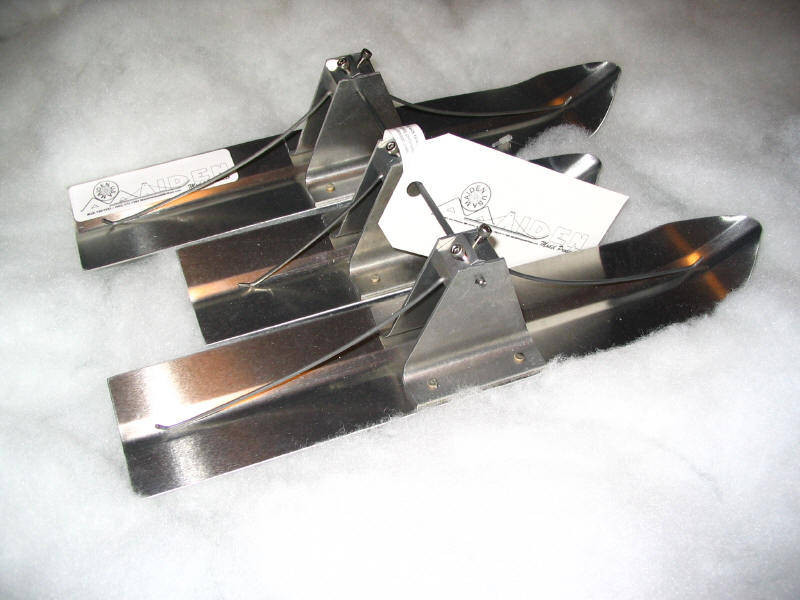

I am looking to have some fun with my trainer (Alpha 40) this winter, and I want to try flying it on skis. I was also planning on converting it to a taildragger over the winter. My question is, is it easier to fly with skis on a taildragger or a trike? It just affects when I will do the TD conversion.

I've done both and it is a little easier to fly as a trike, because you don't have to worry about nosing over and you have more surface area supporting the plane. On the other hand, if you buy skis, a trike set is a little more expensive.
If you are planning to buy the skis, I highly recommend those produced by Maiden Model Products. You should be able to find them on the web. They are the best I've ever seen and have a really good system for keeping them in place, which is a big problem.

Thanks. Those Maiden skis look very nice. I may try and make a set that are similar. If I fail, I'll shell out the $50 for the real thing.

They are nice. The key is the machined mounting block that holds the set screws and the retaining springs. It allows them to flex and stay in place. Mine were in a pretty serious crash and I was able to just bend them back in shape. No other damage.

I found out the hard way that skis won't work with very soft snow, we got 6"+ of powder and my plane just kept sinking into the snow, floats would work better in soft snow.

I like the tail draggers. If you get old snow that has crusted up from sun & then refrozen the front ski tends to bounce up into the prop. Tail-draggers can be a problem on snow/ice in a crosswind. They REALLY weathervane . . . but generally the runway is wherever you want to make it so it's not a problem unless you're limited by footprints in the snow.
On the other hand a nose ski in a footprint can end a taxi very abruptly.
