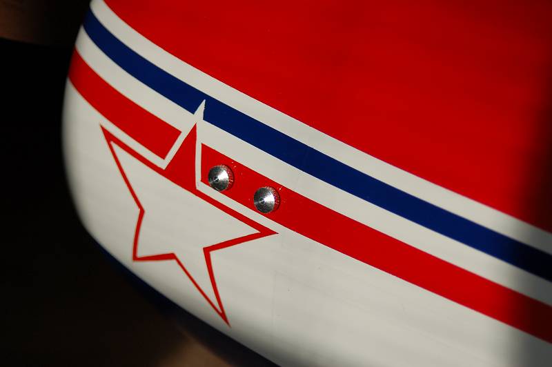

Fill valves really have lousy track records. I don't know anybody who has used one that hasn't gone to other methods.
What any of the methods boil down to is having two holes in the cowl versus one. And then, what you make those holes look like.
There are somewhat expensive plugs that look pretty nice. Fuel dots, I think they're most often called.
And there are cheaper ways.

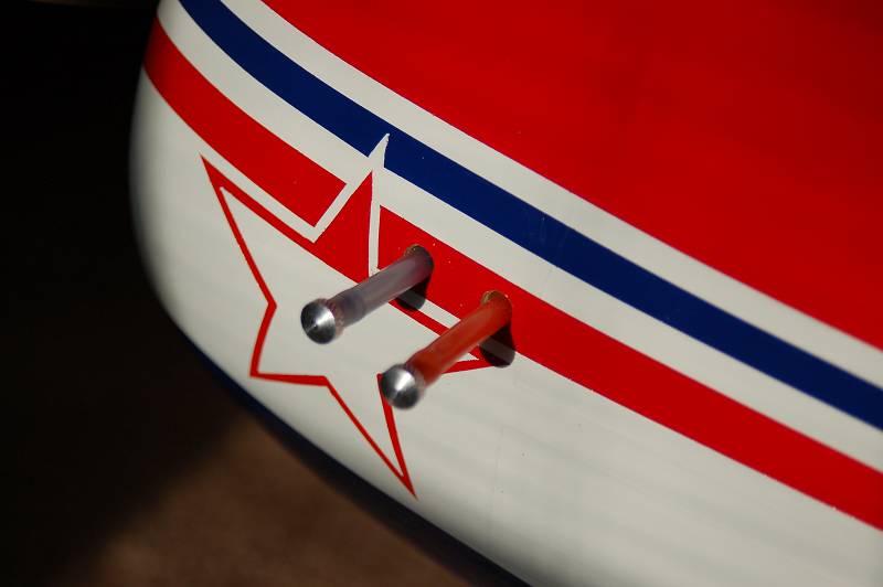

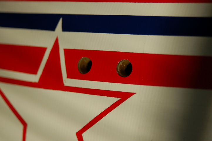

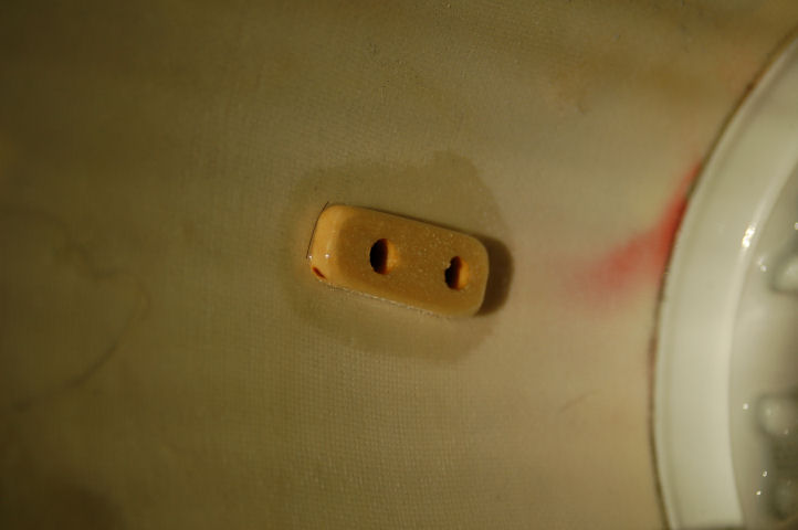

Old 10-06-2007 | 09:33 AM
Joined: Oct 2005
Posts: 11,517
From: Near Pfafftown NC
Default RE: fill valve question
In those pictures, the forward line is the fill line. The rear is the overflow. That airplane happens to have a uniflow setup in the tank. So it was a 3 line tank to start. So the overflow line is simply a straight line back to the tank pipe that is the overflow pipe inside the tank. The fill line you see goes to a T in either of the other two lines. I'm not even sure if it's the pickup line or the pressure line.
To fill, I pull both lines out like in picture 3, pull the two plugs and fill through the front line. When the back one spits, I plug the two and push them back like in picture 4.
The plugs cost something like 50cents each. I'd make my own, but why?
