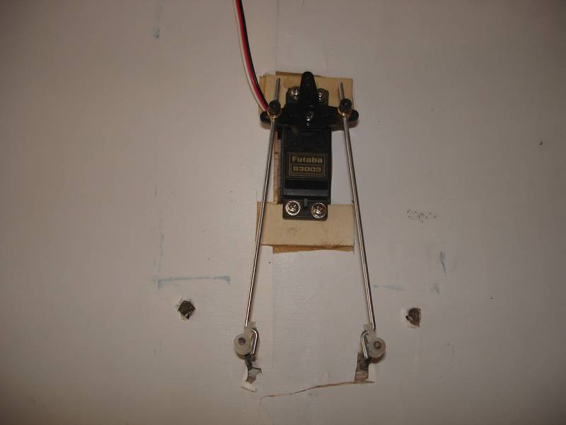

Can you post a pic of your servo installation and linkages?

Hard to tell from the pics but it appears the the torque rod arm may have a fairly large lean forward toward the servo. This will automatically induce some differential. BTW - some sill give you a hassle for using those connectors on the servo arms but I won't because I use them too. Just be sure to use the metal retainers and get the screws tight enough.
Try a 6 arm wheel and install it with an arm dead ahead and aft but don't connect to those. Attach to the pair that are toaard the leading edge and see how that works out. This will induce differential.

Whenever the servo arm and the pushrod do not make a 90degree angle, the pushrod will be moved more in one direction than the other.
Same situation where the pushrod connects to those torque rods in your picture.
AND same situation where those torque rods bend down inside the wing and go out into the ailerons.
The servo does its moving in a circle. The circular motion winds up being sort of a straightline push and pull for the pushrod. When the pushrod is connected on the servo wheel or arm at a 90 degree angle, the pushrod is basically at the center of that circular motion it will see when being pushed or pulled. So when the servo moves 45degrees either way, the pusrod moves the same amount both directions. But say you were to connect the pushrod on a servo wheel at the 45degree location.
Clockface example.......
Pushrod connected at 3 o'clock.
Servo move to 1 o'clock or to 5 o'clock and the pushrod moves the same UP and DOWN.
Now connect the pushrod at 1 o'clock.
Servo moves from 1 to 11. How far would the pushrod move? Almost wouldn't move up and then would move just as little back down
Servo moves from 1 to 3 and the pushrod moves down as much as it did moving from 3 to 5 when it was connected at 3.
That's how people get differential out of their pushrod rigging.
And that's also an example of what happens when the angles aren't 90degrees.

Hey, goirish, do me a favor and check something while you're messing with your ailerons.
Hold the torque rod fixed with one hand and try to move that aileron up and down. If it moves at all, there is a simple fix. And more to the point, that sometimes causes the ailerons to be out of square (the 90degree angle deal) and show more throw one way or the other. Needless to say, check both ailerons.

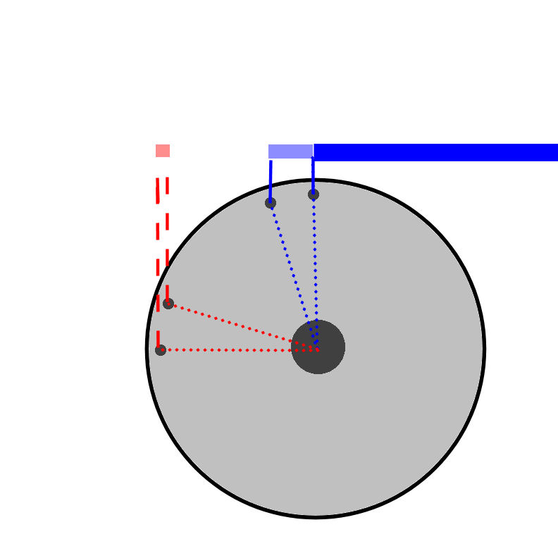

Here we have a servo wheel with a pushrod connected. Pushrod is blue and connected at 12o'clock. You move your stick 15degrees and the servo moves the amount shown by the blue dots. Pushrod moves the light blue amount.
Now connect the pushrod to either of the holes at the red dots. Move your TX stick 15 degrees and the servo moves the same rotation it did just before. But the pushrod barely moves except sideways.
That's how differential happens at the servo.

OK, let's try another busy picture.
The picture shows 3 pushrods, a blue, a green, and a red one. They are attached to a round servo wheel.
When the servo wheel moves 20degrees, the blue pushrod is pulled to the left the amount shown by the purple bar.
When the wheel moved that 20 degrees, the red pushrod is pulled the tiny little amount shown by the pink bar.
That shows how the same movement of a servo wheel in a circle can wind up moving pushrods different amounts in a straight line.
Now lets look at how to use that to drive a pushrod one way a lot and pull it the other way just a little, from the same amount of rotation. The amount you get when you move your TX aileron stick full left or full right.
The green pushrod is hooked to the servo wheel as shown. And the servo is sitting at neutral. Your aileron stick is centered in the TX.
You move the stick all the way right, and let's say that moves the servo wheel clockwise about 45degrees. The pushrod moves to the right the amount shown by the big green arrow.
Now you move the stick all the way left, and the servo wheel would move counter-clockwise. The pushrod end moves to the left and down but only moves left the amount shown by the little green arrow.
If the green pushrod had been hooked to an aileron, it would have pulled it a little bit one way, but would have pushed it about 2-3 times as much the other way.
