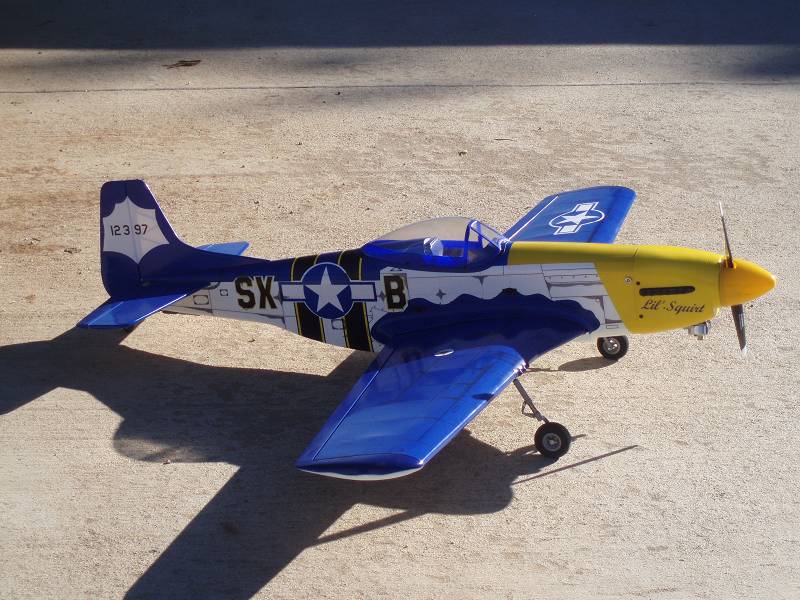

This is my third ARF. First was a Nexstar and then H-9 Pulse. I now have a VQ Warbirds P-51D. The "instructions" (use this term very loosely) say to put the CG at 132mm from the LE. I presume that I am to use the LE were it intersects the fuselage, and to check the CG with the plane inverted and the wheels in the upright (not down) position. I have used a Great Planes CG Machine (seems to work good) and have it dead level at 132mm. I have learned from reading other threads that it is better to be a little nose heavy than tail heavy. So, can you guys tell me how the plane will fly if the CG is off? I mean, if the instructions are off or wrong, or I have made a mistake, what are the tendacies (what will the plane do, if I can keep it in the air) if the plane is a little tail heavy or a little nose heavy? Thanks in advance for your help.
Pete
In case anybody wonders, I named the plane Lil' Squirt after my daughter's nick name. The numbers on the tail are her birth date. She got a big kick out of it. I painted the nose yellow and got the graphics from Bill Fulmer at www.customcutgrafix.com . He seems like a real nice guy.
Pete
Every plan I have built, the "suggested" CG already gave a slightly-to-very nose-heavy condition. Even full-sized craft have a "range" within which the CG must fall. Otherwise, they could never allow for the fat guy to sit in the back seat, or the skinny guy to sit up front.
Setting it there should be fine, but you should probably expect to need to move it aft slightly (as your skills and experience with that model progress), by removing weight from the nose or positioning the battery farther aft.
