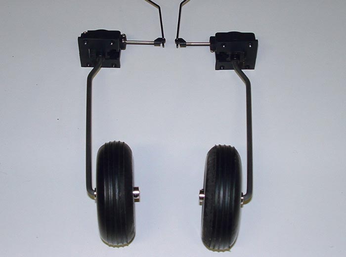

And here's a set I bent with a vise and hammer
ID:	784127   Click image for larger version
ID:	784128   Click image for larger version
