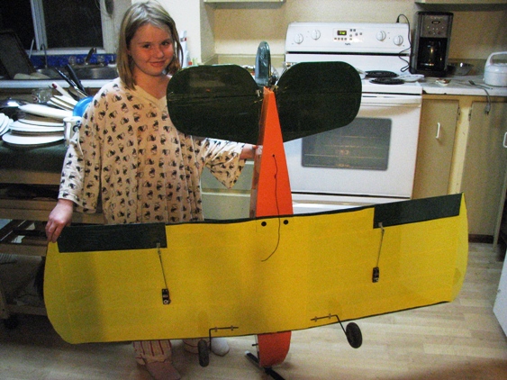

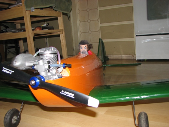

sdg666, Ijust recovered my slowpoke arf. Had a Evolution 45(trainer motor). Probably a couple hundred flights on it. Just got a gift after i recovered it, a Evolution 60! ( Thanks to fatherinlaw). Couldn't decide what to do with it though. Thought about putting it in my twist ,but think it would barely fit + os46 seems just fine in there. The slowpoke had to have nose weight with the 45. Soo im thinking it will balance close with the 60. Will have to check balance,prop clearance,throws and will be good to go. Might test fly this weekend, if it doesn't snow to much, or get ski's. Ive overpowered a couple of my planes with this motor and have been pleased: Lt-40, Sig 1/5 cub.will try to post pics. i usually just read on here.

man i have a tough time posting pics.
[img][/img][img][/img][img][/img]

Looks like you got the job done.
Nice plane and family

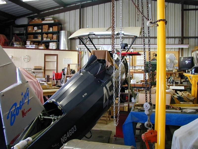

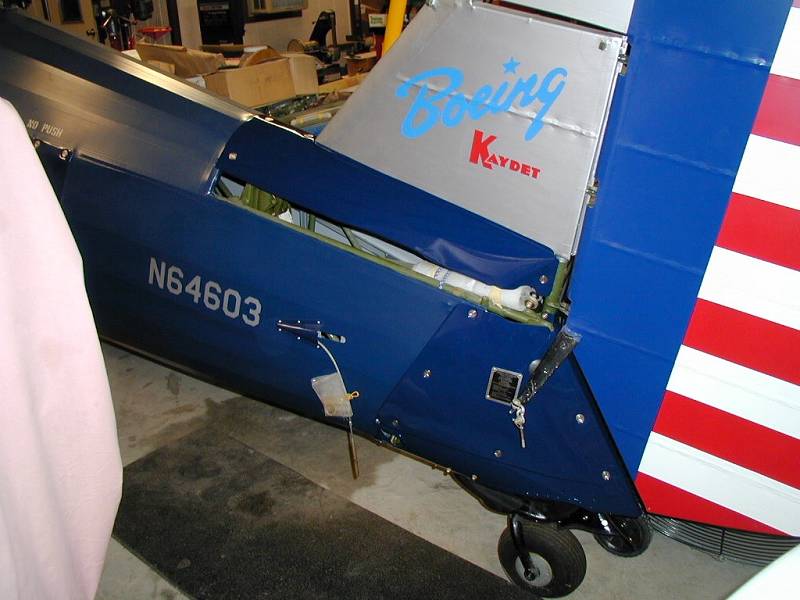

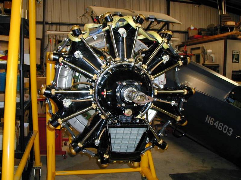

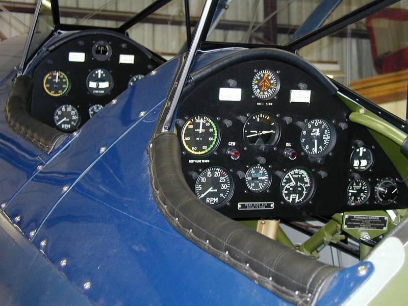

Well, Bob, if the truth were to be known, I DO have two Slow Pokes. The first one is the smaller (3ch) Poke and is the one I'm electrifying. I won't be adding retracts to this one but I am considering converting it to a trike to give it a Culver Cadet look. And no, I won't be adding ailerons to it because the ailerons and polyhedral wing would fight each other. The solution would be to flatten the wing out but then you might as well just get the 4ch Sport 40 version - which I also did.
After reading all of the posts here about how the Sport 40 is the "perfect" sport flyer, I went out and got one as a follow-on to my first Poke. This one WILL have a 4cy (thanks to the constant brainwashing by RC Ken! ) and I've already picked up a set of Robart's mechanical retracts for it. (I'll be sticking with conventional gear on this one.) However, the Slow Poke's spar layout is going to make adding retracts difficult but that'll be part of the fun of the build, right?
Yeah, I'll keep you posted on my Electric Poke but don't look for rapid progress - I'm still trying to get my Stearman finished and flying. THAT build is entering its 9th year! It's a "Boeing kit.") It has a 4cy too.

I'll look for your post in the future. BTW that is good
looking 9 year old project lol. Stay with it.

That looks like a 985 not a 1340 like it says on the airworthiness certificate?

w8ye, you looked my N-number up on the FAA website. That's quite resourceful.
Actually, it's an R-755 - a 275hp Jacobs from a Cessna 195. (But I'm expecting someone to ask me what size Saito Golden Knight it is. )

It's been 40 years since I was around a 985 or a Jacobs. The main thing I remembered was that a 600hp had 9 cylinders and I was thinking a 220 Continental had 5. There were a lot of different engines in Stearmans.

The 220hp Continental and Jacobs engines have 7 cylinders while the 220hp Lycomings and 450/600hp Pratts have nine. You might be thinking about the 5 cylinder Kinner engines that were on the little Ryan monoplane trainers.

5487 , that is awesome , if we lived closer , I`d give you a hand. Very nice work , the 9 yrs shows.
