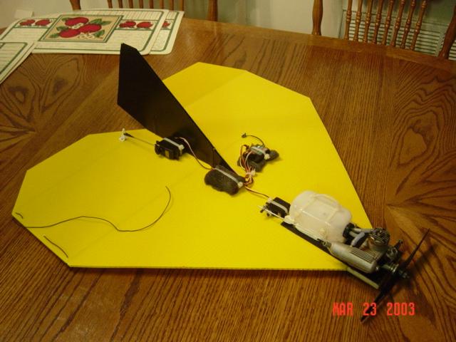

heres mine.
I also have a Diamond dust but like this one just as good
its a $5.00 arf from the huntsville Swap meet.
wish i'd a bought 3 more.
this one has an os 15fp standard servos for elevons
and mini for the throttle.

Bob Payne
Where does your delta balance? I am going to build a similar plane out of chloroplast.

Originally posted by KCFlyBoy
Bob Payne
mine is per instruction, 9" from front of engine mount

kcflyboy. there are a couple of SPAD deltas, from the delta PBF's to the corodust and mr greenspeeds new ez pusher delta (not test flown yet), i think most of the deltas have the GC at about 15% MAC.
