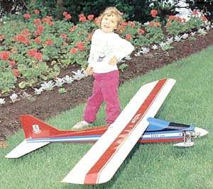

Is the the plane you have? If so, the plans are still available - direct from RCM plans service:
EASY 100
Our Price $21.50
by Laddy Mikulasko,
70" span, 822 sq. in., .40-.45, 4 ch., built-up balsa, plywood, and spruce, two sheets 35" x 59", 35" x 71",
Issue: RCM 7-88,
Old 10-31-2007 | 08:05 PM
Joined: Oct 2007
Posts: 36
From: Woodstock, GA
Default RE: Amazing find!
Yea thats the one. I have plans I need a wing. Im probably going to just build one. Thanks
