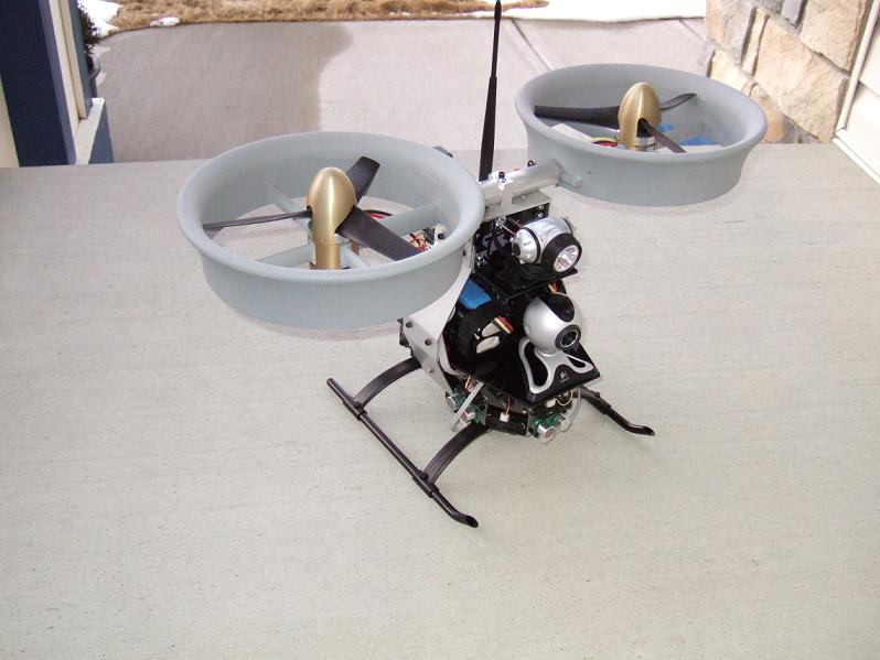

Joined: Sep 2007
Posts: 542
From: Toronto,
ON, CANADA
rmp/v means just that, but don't get confused that more load the motor has on it the rpm drop i.e. a prop.
Higher rpm/v motor usually use gear reduction to achive higher torque. The motor is cheaper but yo have to pay for gears.
Gears however allow you better speed control especially at low rpms.
Ducted fan units however need as many rpm's as possible.
There are more exact sciences envolved here.
I think i know what you are trying to make here. i have seen something similar
[img][/img]
[img][/img]

Healthy,
What size model are you looking to get off the ground?
I am not sure that the current computer radio for R/C has the ability to control 3 or 4 motors ESC's in the manner that you want.
You will need to mix the ESC's for pitch and roll as well as be able to increase/decrease all throttles propotionately unless the model will be teathered, or secured in some manner to prevent adverse attitudes.
Does the model have to transition to conventional flight after takeoff, or just hover?
Bob
Bob

I used to do a lot of vertical take-offs and landings with these:
Straight up. Straight down (unless a thermal catches it and then it's off to Nova Scotia and points East).
