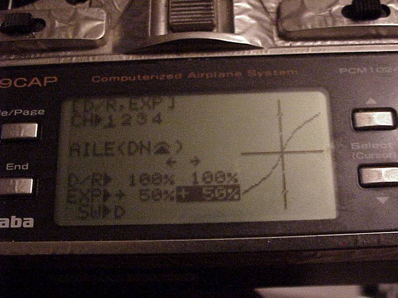

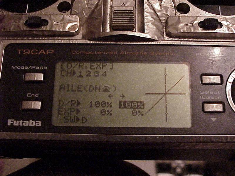

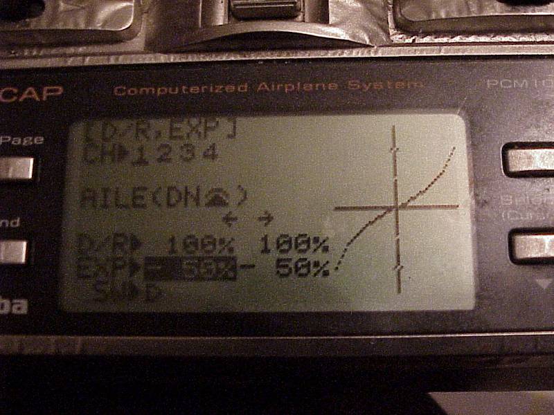

Here are shots of my Futaba 9CAP Expo screens the first is with 0%. and the line goes up an equal amount as movement.
The second is with -50% and as you can see the servo movement is less per unit of stick movement untill you get to full travle
THe third is with +50% and here the movement is more untill you get to full stick travel.
Just remember, you set each direction individually. You can get some really screwy responses if you don't keep things moving coordinated. I about lost my plane last week because I had screwed up the movement and the results were noting like what I was trying to do.
