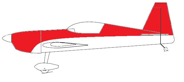

Ok I get it, but the problem is that I want a really big curve that changes radius so it yields a more complicated problem. I need to cut the red monokote for the following design:

Posterboard template and fine point marker to make exact cut line then cut it with a VERY sharp blade or a GOOD scissors.
Also the OLFA cutters with the nice round blades (must be used on a cutting mat) that you can get in walmart sewing section are REAL sweet for monokote cutting.
A fresh pair of scissors from the sewing section is a good stocking stuffer get a pair for the wife too!!

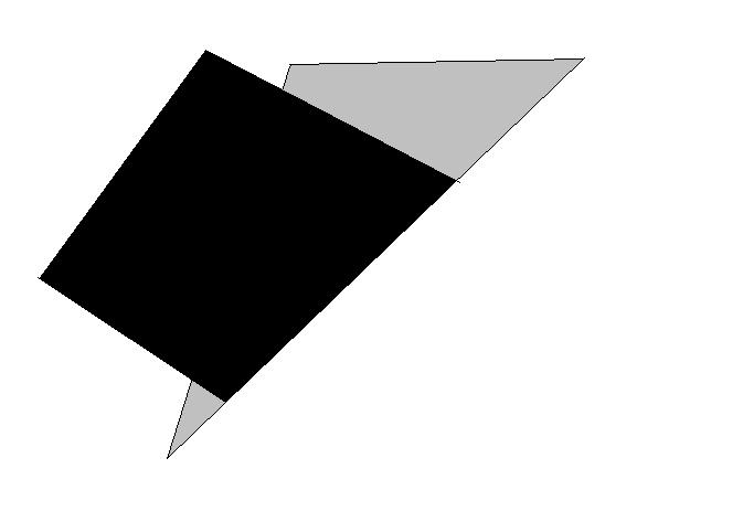

My idea In this case:
Maybe to cover big part of the blade with tape, then create the pattern from a cardboard and with two layers of monokote to get a mirror image cut the monokote.
If you leave just a millimeter of blade exposed it will make a cut without cutting into the cardboard.

If you layer two pieces of MonoKote together, topside to topside, so that you cut mirror images, stick them together with temporary double-sided Scotch tape. It will hold the pieces well, but easily strip off when you're done. Put the tape along the cutline, and cut through both pieces of covering and the tape. That way, the covering won't move as you cut it.
Cutting on a large piece of glass also works very well, but it will dull the knife blade quickly.

I solved the problem using a french curve set. It worked like a charm.

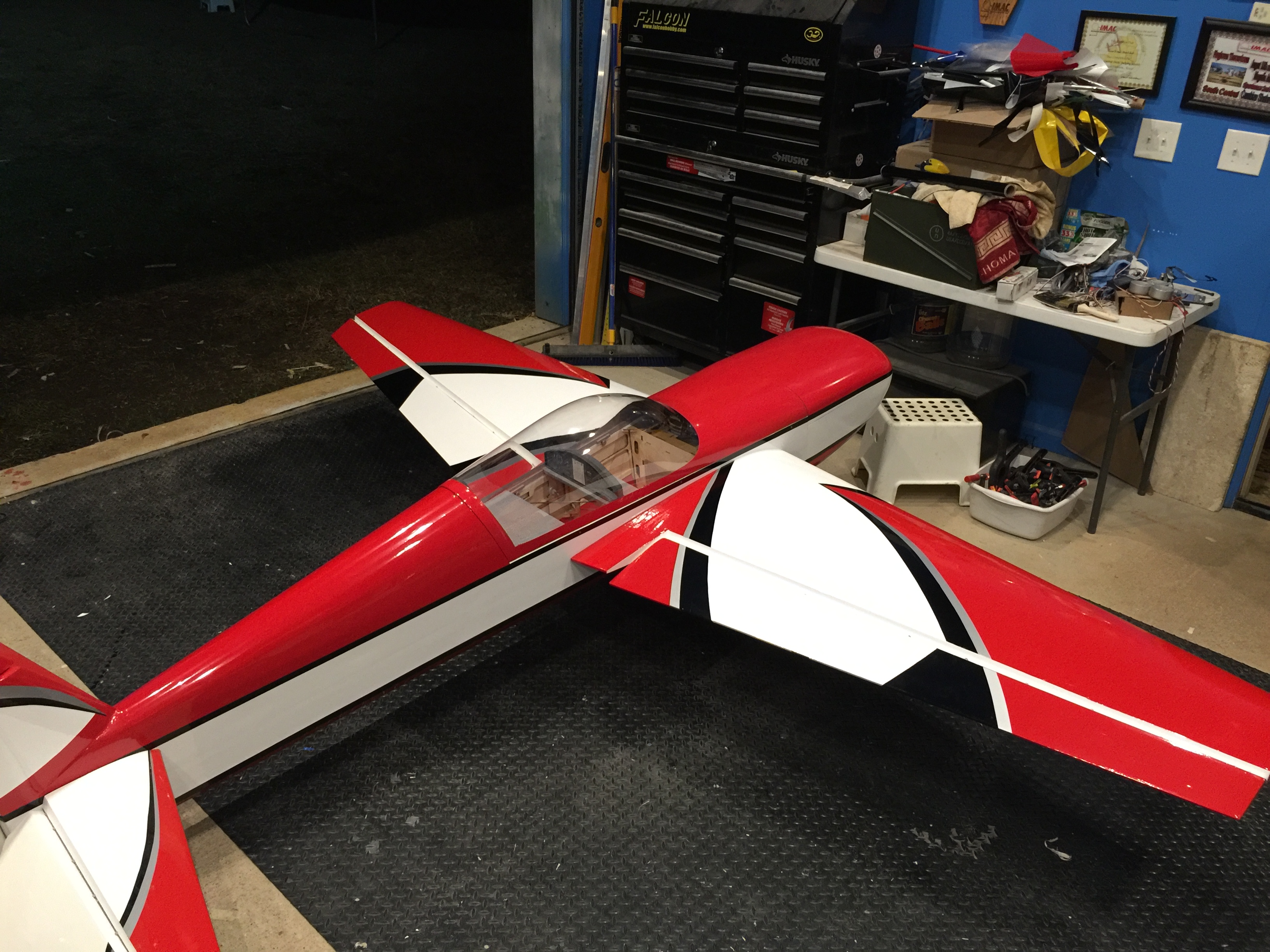

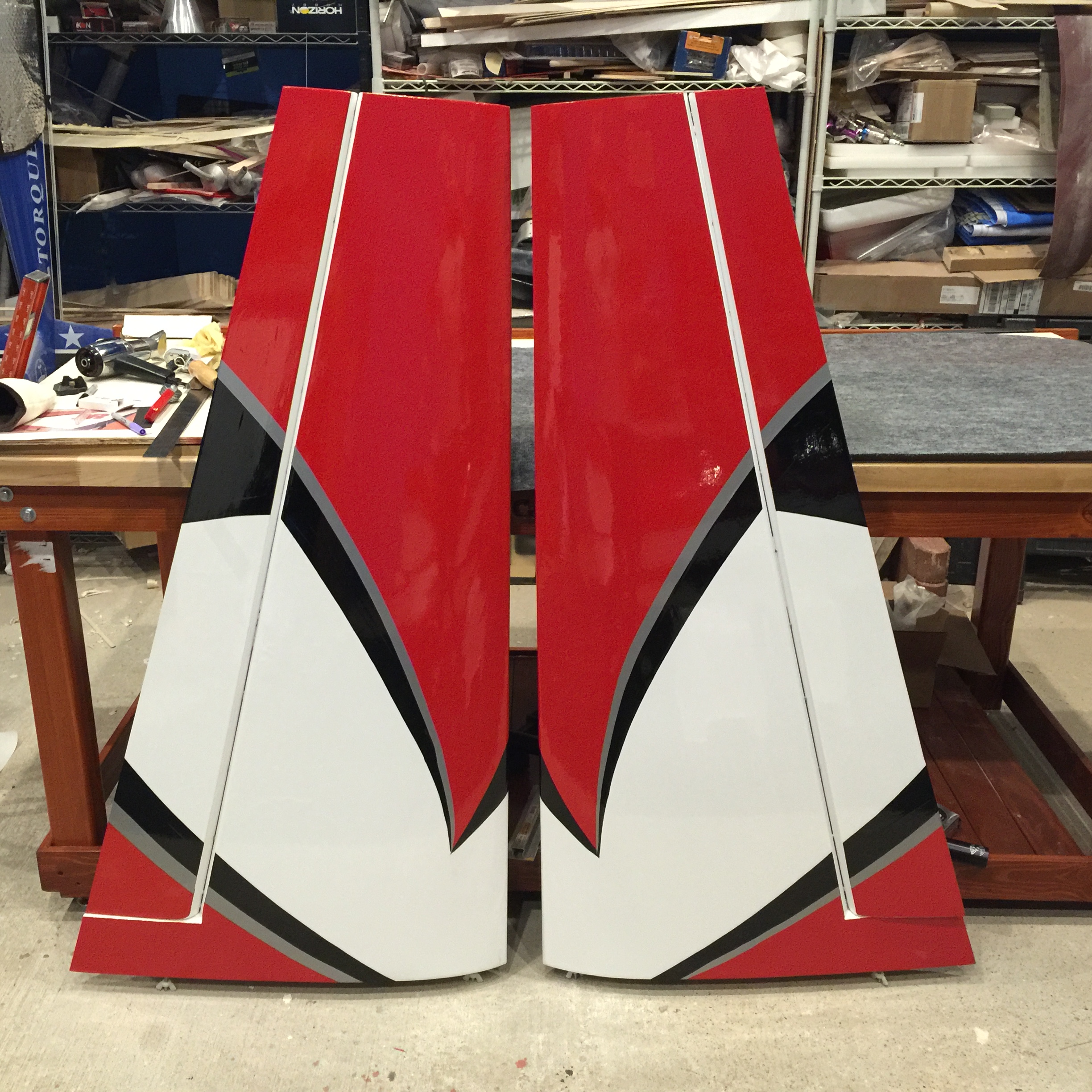

anyone know where I can get these plastic guides or templates? or what they are called so I can search for them. I too want to cover my airplane with Monokote, and there are some curves in it. this is the last one I covered, and it was mostly done with a cardboard template, but I was not totally happy with the results.

Google for "French Curve Set" and you'll find a bunch.

I usually flip the monocote upside down and use a marker on the release plastic on the bottom of the monocote. if I have small intricate cutting to do I use spray adhesive to the release film of printed templates. I cut on cutting boards for big things but use glass for small intricate cuts and when I have to use the press and seal release method to maintain spacing on designs
Old 03-25-2016 | 06:51 AM
Propworn's Avatar
Posts: 2,489
Received 32 Likes on 26 Posts
From: Canada
Many times I have cut durable templates from aluminum siding trim rolls. Its cheap and if you polish the edges the razor blades slide along nicely. For really irregular curves I pin a .032 diameter of piano wire to the shape of the curve I am looking for then use it as the guide for the razor blade. I only use single edge razor blades they seem to hold up better and for me buying them in bulk are cheaper than the #11 blade.
Dennis
Old 03-25-2016 | 08:10 AM
Moderator
Joined: Dec 2006
Posts: 7,266
Received 35 Likes on 30 Posts
From: Fort Worth, TX
I make a cardboard template on the plane, then mark the Monokote with a sharpie.Then I cut it on a plastic cutting board. The plastic makes the blades last longer, although they never last very long anyway. I've found that trying to follow a template on the Monokote usually results in mistakes as I tend to press into the template or will drift away in an attempt not to press into it. But the black sharpie line is easy to follow for good results every time.
