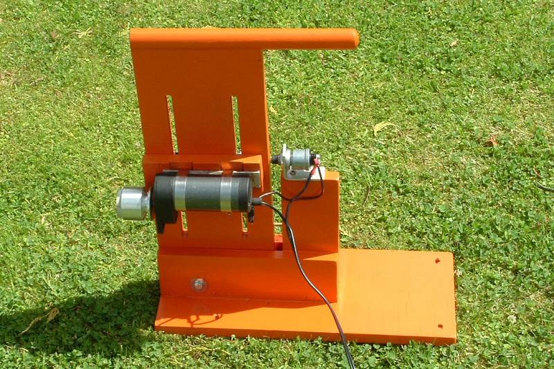

Well finally my finger has healed up and I can shower again without wrapping the finger in plastic bags and so on. I am lucky, it has healed very well only tender at my finger tip. I am hoping this tenderness will disappear over time. My nail is still pretty mangled and I am expecting it cause some problems in the weeks ahead as the damaged section slowly grows out. I used some 5 min epoxy to stick down some of the fragments and smooth the nail, it seemed to work OK.
I have finished the safety starting device as per Kelly Reagan's design, and are very pleased with it. This device enables the plane (and engine) to be put onto the starter working from BEHIND the engine and propeller instead of presenting the starter to the engine from the front of the plane and in front of the propeller. On test yesterday it certainly seemed to work as it I expected to. The real test will be when I go flying later next week. (My instructor is away on holidays until then.)

Yes the use of a starter stand should be just normal everyday practise and procedure for everyone, but in my experience it is not. I even cut out and gave all the wood and associated parts to two R/C friends to make up their own starter stands. Neither has done anything further with them, very disappointing, yet if I am around when they are flying they jump at the chance to use mine.

Hi davidbegg
With the starter stand you show in the two photos, would you be able to get to your transmitter if the throttle happened to be wide open when you started the engine? That is a stupid error that has happened to me about three times. With a 60 size or larger engine that can be very challenging and dangerous. The Engine Starting Safety Stand that I use and recommend can accommodate this error.

I don't see the transmitter being within reach as a problem. I have the starter firmly secured to the ground (I use a couple of cheap long screw drivers driven into the ground through a couple of holes in the starter to achieve this, works well) I have a 'u' shaped plane holder thing again securely screwed into the ground via a piece of coiled steel(came from a picnic dog restraint I found in the hardware store.) I secure the plane restraint about 500mm plus the length of the plane behind the starter. I place the transmitter on the ground by the tail of the plane. I am easily able to push the plane into the starter holding the plane around the main wing. If I need to adjust the throttle the transmitter is right by my hand. When the engine starts it is simple matter to move the plane back and put the planes tail plane into the plane holder, the transmitter is then about the wing area of the the plane and can easily and safely be picked up to adjust or check the operating engine. A friend made me a plastic cradle for the transmitter to sit in so it doesn't lie on the ground, but this is not necessary.
I agree electrics also need care, once the battery is connected , knock the throttle on the transmitter and the motor starts. Also electric motors won't stall if they hit something (including YOU) but will just keep on chewing. I am not aware of any light weight switches that will handle 20, or 30 or 40 amps which electric motors will draw, so a switch is not an option. However I am thinking of an automotive fuse (available in high amperage sizes) that you can insert into a fuse holder on the side of the plane when you are ready to fly. However I don't know if a suitable fuse holder is available, and this system is putting another area of potential weakness and failure into the radio and motor systems of the plane. Is this solving one problem and making another problem?
