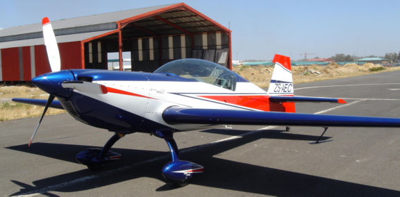

Here is a picture of a 300 and if you look very closely, you'll see a degree or two of dihedral.
The title of the picture says it's the first 300LP.
I see a flat top wing with a taper on the bottom. I guess that's technically dihedral.

ORIGINAL: Dr1Driver
Dr.1
Yes, that is dihedral. The upper surface of the tapered wing is flat, but structurally, the wing has dihedral. The centers of the tips are raised compared to the center of the root. A truly flat tapered wing would have the leading and trailing edges flat, the upper and lower surfaces would not be flat (following the taper), and the tips would be on the same center as the root.
