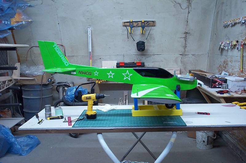

I also built a Tiger 60 this past summer. I used standard Airtronics HS-300 servos and 4.8v 600mah battery pack that came with my RD6000 radio. All work great. By the way, this was my first low wing plane after a trainer and it is easy to fly. Your son should have no problems.
Also, Tigers tend to be tail heavy. When you build the kit you'll see that there is a lot of room under the fuel tank. Instead of gluing in the fuel tank platform, I glued some rails to the fuselage side then screwed the platform down to the rails. It is easy to remove the whole assembly and place weight or battery pack underneath in order to balance.
