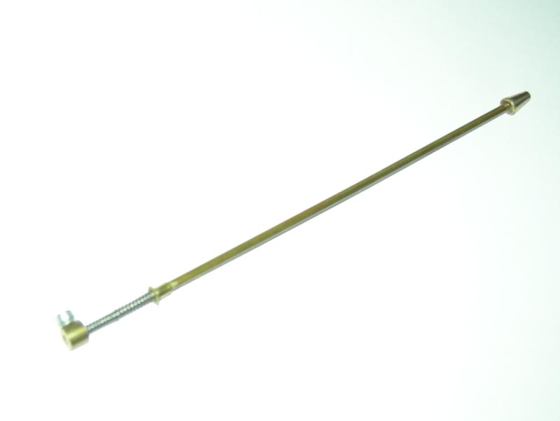

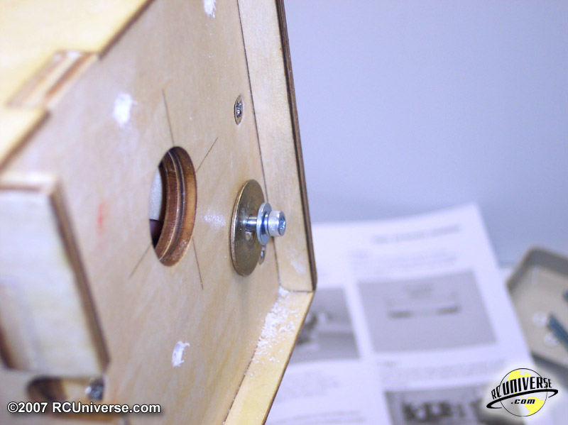

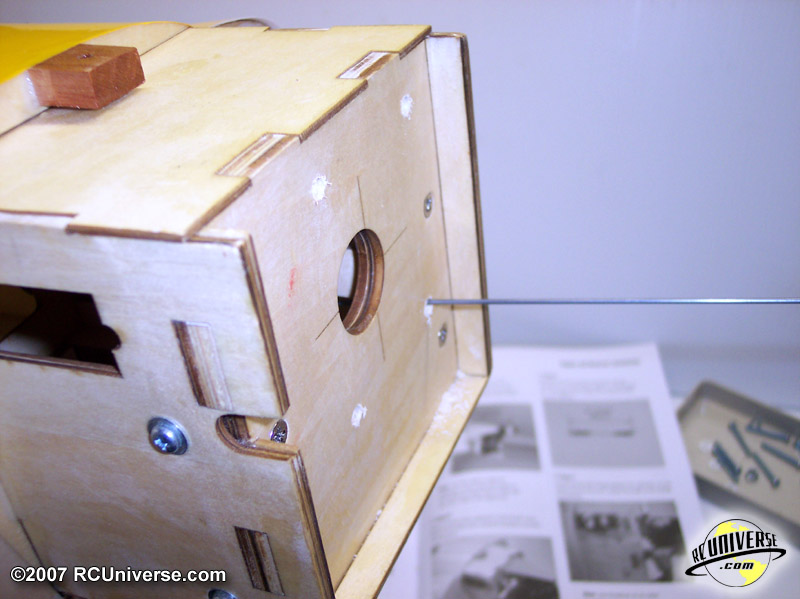

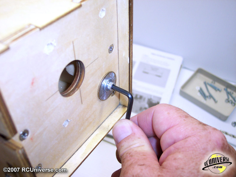

For setting a blind nut. There are several really good "tricks" that can be used. Here's what I do. Get a wire pushrod and slide it into the fuselage through the hole you want the blind nut in. When it's in the fuselage slide your blind nut onto the pushrod and then use an easy connector behind the blind nut. Now pull the blind nut back through the fuselage to the backside of the firewall. Once it's up to the wood pull it into the wood enough to set the teeth into the wood. Remove the pushrod and then thread a bolt through the firewall into the blind nut and tighten it to completely set the blind nut into the wood.

Believe it or not RCKEN....I knew you would reply.....with an EXCELLENT response of course. Many Thanks! The pics are a bonus.
Quick question: Would it be good enough to relocate only one side of the mount? What would be the best way to line up the mount if I moved both sides? Is an approximation good enough?
Also...Can I reuse the original nuts or a new ones best?

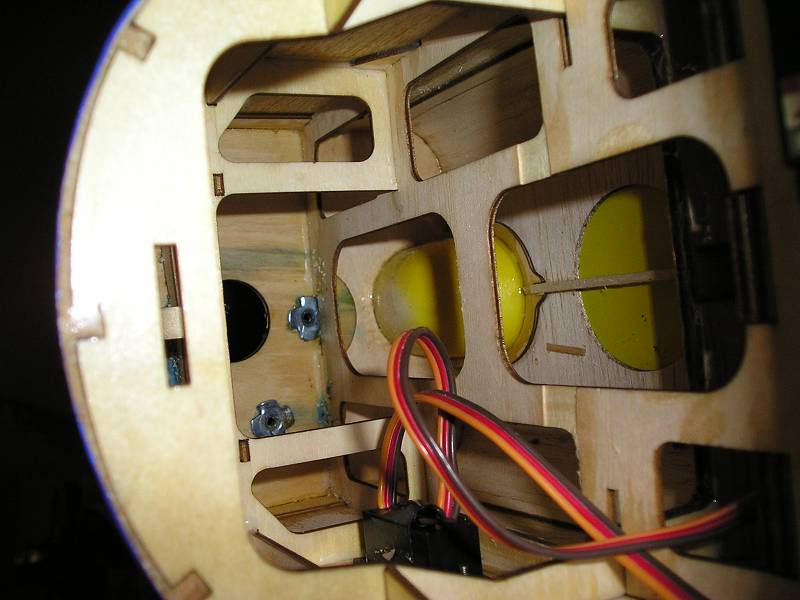

RCKEN - I have pulled my blind nuts and am test fitting the mount I am thinking of leaving one alone because it is blocked in by part of the frame behind the firewall. I cant get in there to cut away the frame, replace blindnut, and replace wood once done. If I leave like this, it will bring the centerline of the engine off by about 5mm. Will this make a difference?

This is on a Hanger 9 SHowtime 50. The specs call for a. .82 four stroke. I am using a Saito .91. When I originally mounted the engine, I had to shave some of the insides of the engine mount to get the engine to fit. I wasnt really crazy of the idea thinking I was weakening the mount. In order to get the engine to fit, I need to space the mount holes on the firewall further apart.
RCU Forum Manager/Admin
Yeah, that may be a bit much to shave off. So let's see if we can solve the problem of the blind nut. When you try to insert the blind nut what is interferring with it?? Tri-stock on the back of the firewall??

Here are some pics. If you look at the first...the two dots on the top are where the new holes would be if I was to utilize the existing mount holes on the bottom. The second pic shows the cross brace which I cant get to to remove and replace once I remove the blindnut just in front of it.
