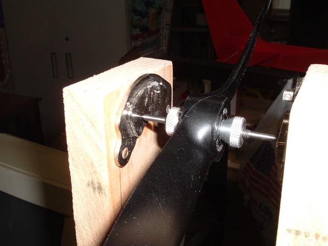

is prop balancing a necessity? ne home made way to do it ?

Prop balancing reduces vibration and helps with wear reduction some. but painting tips and removing the sharp mold flashing is a safety MUST DO. A 40 size prop say 10/6 at WOT moves at the same speed as a .45 cal. bullet. OUCH EVEN!

I have a finger tip balancer, and suspended it between a pair of magnets glued to a couple of pieces of scap wood. Since the finger balancer ends are pointy, and the magnets are very hard, there is almost no drag, and you get a very reasonable balance from it. Forget trying to drill a dimple in the magnet, way too hard. (Tried it).
