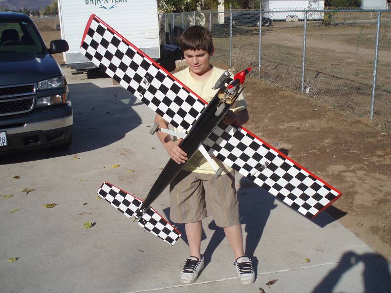

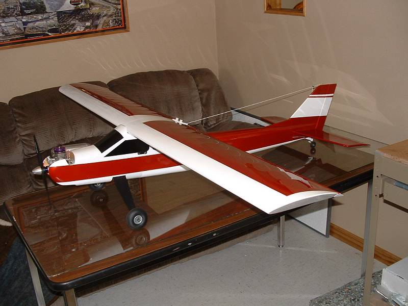

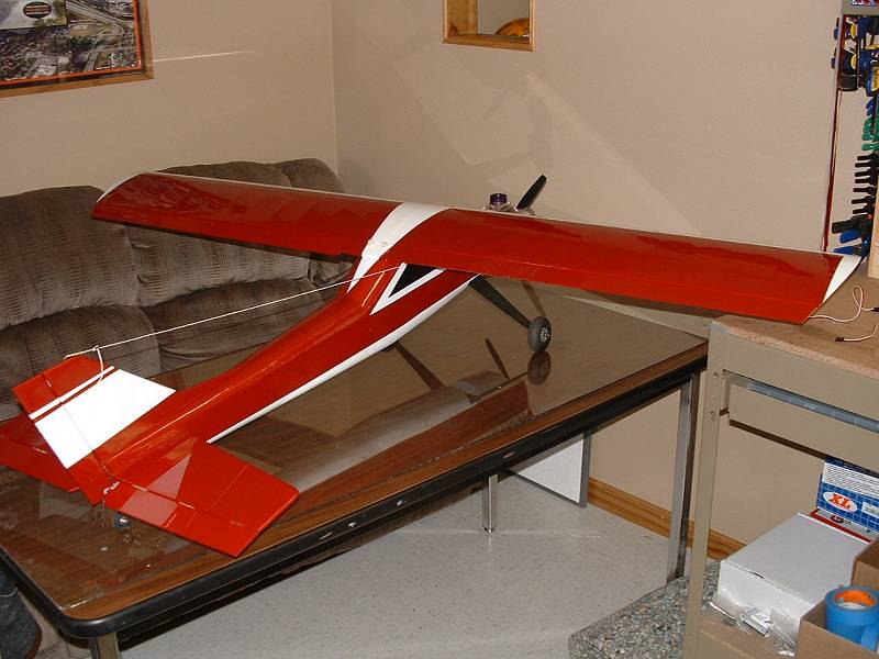

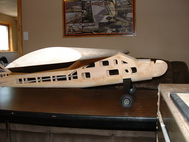

No, I didn't loose it. Just replaced the covering. Like so many other Nexstar owners who didn't seal the edges of the decals before the first flight, most of the decals on my Nexstar started coming off. It started to look pretty crappy, and I wanted to gain some experience covering planes, so I removed everything down to the wood. I found a few problems!
1. Where the landing gear enters the side of the plane was completely soaked with oil because it is not sealed. Oil just flows in around the slots and in the holes under the plane that are there for removeing the landing gear. When I re-covered the plane, I left the holes under the plane covered and sealed around the landing gear with silicone sealant. Hopes this works.
2. The tail area was soaked with oil. My plane was just not covered very well in the area around the tail. The oil also works it's way into the edges where the tail and rear wing are attached. Mostly on the exhaust side of course.
3. Where the elevator attached with the CA hinges on the exhaust/right side of the plane also had a little oil in the wood.
4. I removed all of the CA hinges so I could re-cover it. Most of the hinges that I removed were set into the wood with about 1/4 inch of CA material on one side or the other of the hinge. In other words, it was real easy to remove them with my exacto knife. I cut new slots and and installed longer CA hinges.
I removed all of the oil from the wood with the heat gun and paper towel method, followed up with K2R and Sig Stiks it for good measure.
My son flys it the most, so I let him pick out the color scheme. He is a little color blind, and also had trouble seeing the mostly white plane on cloudy days. So we watched a few other planes and got a good idea on what he could easily see. This was my first covering job. I think it came out pretty good. My only regret is that I read RCKen's LT 40 build and watched Minnflyer's covering video AFTER I covered my plane. I think it would have came out a little better if I would have done that in reverse order! LOL
Anyway, I just wanted to post this for the other Nexstar owners. Maybe just pay a little extra attention around the landing gear, the tail end, and the hinges.

Thanks for the compliments. My son and I scrolled through all of the color selections (of Ultracoat) and he picked them out. My only suggestion was the yellow checked tail.

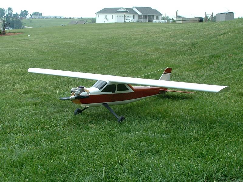

Here is a picture of the "old" Nexstar and our flying area.

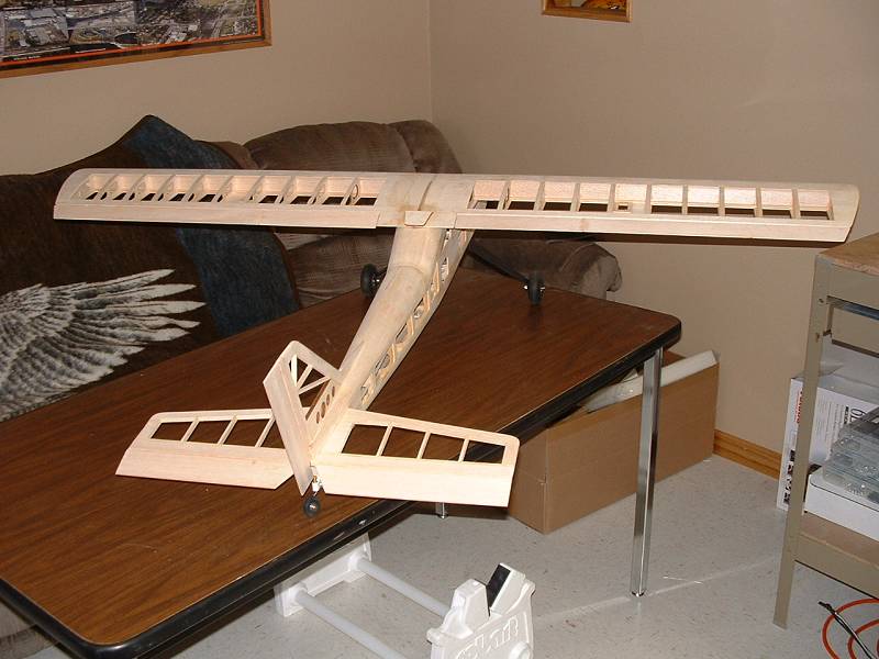

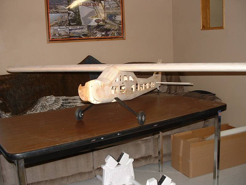

That is a good looking plane. I almost removed some of the dihedral, but my 10 year old daughter wants to learn to fly. So I decided that leaving it in for now was best. She needs a little more time (and patience) on the sim. My cousin wants to convert his to a tail dragger. I can't wait to show him the picture of yours! Yea, my son like's it alot, and can't wait to go flying, maybe this Sunday, I hope.
When you removed the center brace, did you add in a wooden dowel to the LE to take it's place? Looks like a couple of plastic bolts holding on the rear. Really cant tell for sure. Could you please give a brief detail on how you did that? Or maybe some pics if you have them?

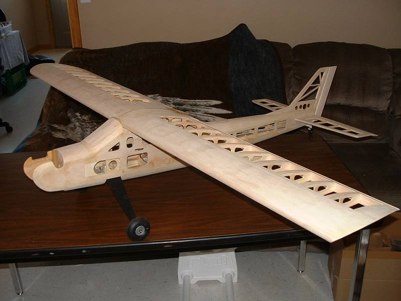

Sure pete, I'll send some pix thursday, Basically added a 1/4" ply brace between the wing halfs with a small "L" shaped tongue on the bottom of the wing that goes into the former, just like a dowel,then added wing hold down blocks and two nylon bolts for hold downs. I always loved the way this plane looked, thats why i put the time in. Good idea not to take the dihedral out for the yougster, it handles alot different. Very responsive. The enlarged elev. & rudder sure wakes this plane up in a nice way. It really looks scale on take offs/landings. With flaperons I can bring it in real slow and smooth. Sorry to step on your post-just love the next star as a rebuild.
mark
mark
Join Date: Apr 2007
Location: Lancaster,
WI
Posts: 1,111
RE: Recovered my Nexstar

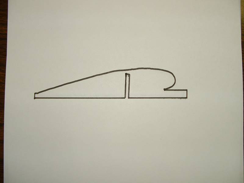

Can't find a picture of the brace but I scetched one out. Use 1/4" aircraft quality ply and 1/8" same quality for the dihedral brace that replaces that steel rod-at least two bays in on each side.

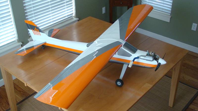

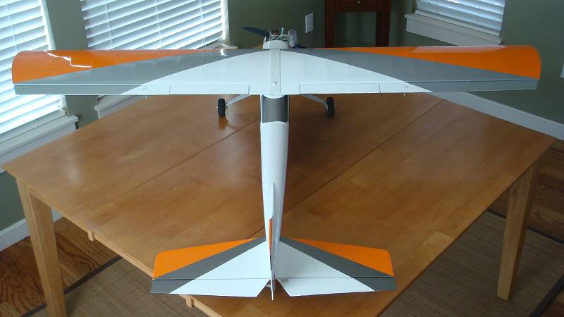

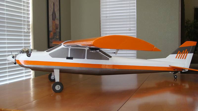

I recovered my Nexstar over the Fall/Winter break. I was inspired by the Spektrum colors, and have received many compliments at the field. I used paint stipper to remove all the white paint from the landing gear. They now have a cool looking, rough, aluminum finish. The white spinner works well with the colors too. While I had the original covering off, I also converted the model to a taildragger, and removed all the dihedral from the wing. I had already added the flaps shortly after I began flying it. Check out pics in the next post.

To answer some questions, you'll want to check out the other pics and info I posted in another thread. This link should bring you there, see the last three threads by me. http://www.rcuniverse.com/forum/m_31...tm.htm#3175594
Q1 about the forward gear location. It was driven by the fact that the axles of taildragger models need to be slightly forward of the wing's leading edge when looking down on top of the plane.
Q2 about the flap length. The owner's/user manual for the plane gave this spec. If you don't have the manual, you can search online for the pdf version.
Q3 about aileron throw. Yes, I did increase throws on all surfaces. You can do this mechanically with the way the control rods are positioned on the servo horn and surface control horn. You can also do this using most computer radios. I use a Spektrum DX7.
Q4 about damage. Simply cut all the damaged wood out, and if it's not too large of piece, and has no structural ribs/formers/stringers, just iron on a scrap piece of covering to close the hole.
Q5 about your engine out situation. Sounds like the engine was "loaded" up with fuel, and when you moved from idle (or very low throttle) to take off again. Check the low speed mixture...tiny flat head screw inside the moving throttle plate/arm assembly.
Q6 about how to easily change the prop. I never use any tool to hold the crank. First, be sure the threads on the nut and crank are clean and free of dried up/old thread locker. When you have the new prop and spinner mounted, but loose, turn the crank with your finger tips so that the engine reaches top dead center. You'll feel the resistance. With the crank/piston at that position, turn the prop so it's horizontal in position. I then hold the spinner backplate and prop together and tighten the nut. As the nut tightens, the prop really can't spin out of position because the knurled edges of the prop and spinner backplate lock together.
Hope this all helps...happy flying.
