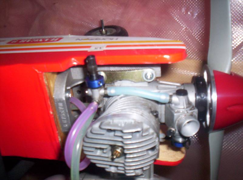

Hello, i have an Alpha Trainer 40 which my wife got me 2 years ago, well the evolution engine blew up in short order ($80 engine that came with the plane so oh well) now i have a brand new OS.46AX-i for it that i got for xmas, the problem is the original motor mount is set up for 4mm mounting bolts and the OS is set for 3mm, and i looks like the mount is too wide as well, any suggestions on what mount to get? and will i have to redrill the firewall to do it?

You may have to redrill. It is no big problem. Take the old one out, and find one that's close at the local hobby shop.. Or, you can get one of the Universal type that mount the engine in a strap. Not the best way, but I have 2 like that, and they have been more than adequate.
You have a great trainer, and now a great engine to go along with it. I just wore out my last evo 45 trainer engine, and used a Magnum 52 four stroke to replace it. It's not as fast, but I like the 4 stroke sound, and it really is enough to train with. As long as you mount it even close, it will work. Of course, the closer you keep it to center, the better. The 1 or 2 degrees of offset thrust is already in the firewall, you shouldn't have to worry about that.

And i just realized i had a brain fart, i forgot the dang bolts go through the straps not the engine block! I swear i get my best ideas when im tired!

My Alpha 40 RTF came with the "strap" type motor mount, so it wouldn't matter what size bolts the engine wanted. It sounds like yours came with a different type of mount.
It shouldn't be a big deal to drill new holes and put a new mount on it. I actually had my firewall pop right out on a hard landing. When I repaired it, I cut a new firewall (minus the mounting tabs), installed new blind nuts, and then epoxied it right on top of the old firewall, with tri stock braces. It did not noticeably affect the CG. You could do something similar if re-drilling the existing firewall and getting the blind nuts installed is too difficult.
