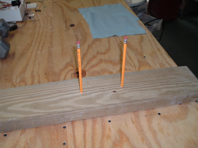

two equal height dowel rods, with pencil erasers on the end will do the trick. Rich

You can even use to wooden pencils and balance the plane on the erasers. Drill two holes in a piece of wood an stick the pencils/dowels into so you can set the plane on them without falling over.

Here is mine in action. Too simple to build....
Yes, I know the Tiger is supposed to balance upside down, I checked it both ways. The only thing you have to watch for is clearance at the rudder / vertical empennage.
