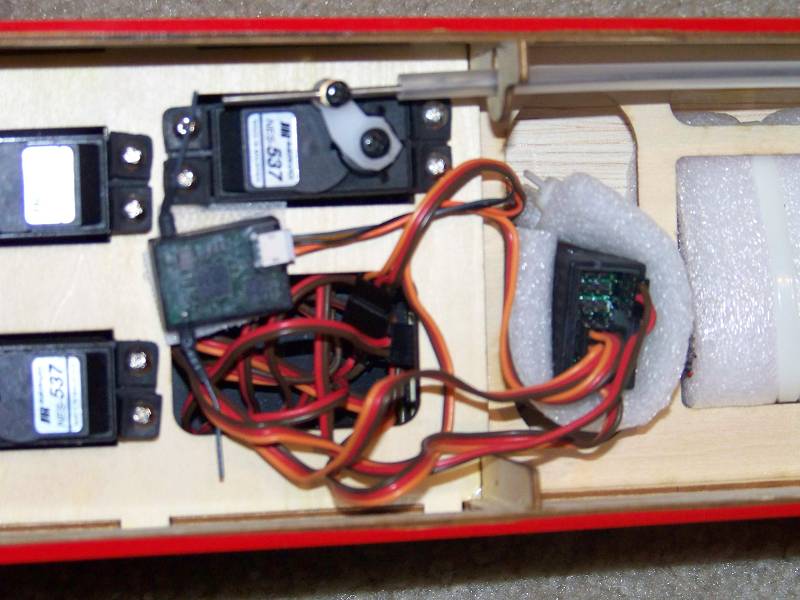

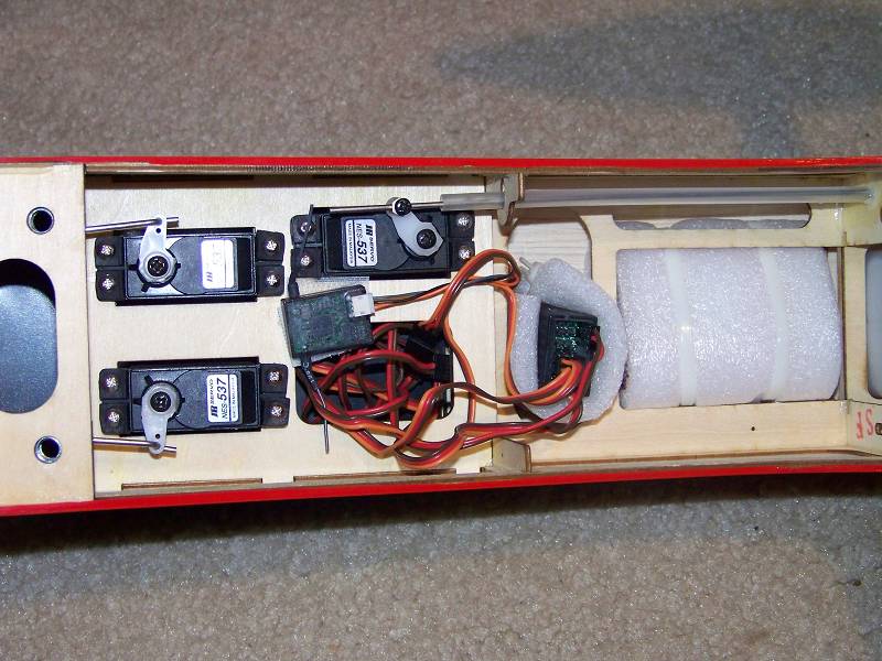

just got a pulse xt pnp and was wondering if this is a good place for the reciever that came with the dx7. will it have good enough range?

I could not see the antenna for the primary RX. Where is that? They really should be perpendicular to each other. The other issue is to try to separate them as far apart as possible from each other. Set them up so one has the antennas running parallel to the wing and one that is parallel to the fuselage.

It's also not good to have all of those servo wires running that close to the remote reciever as they can cause interference in the receiver. You would be better off moving the remote forward of the main receiver. The remote weighs so little that it won't cause any issues with the balance.

how about now? the main reciever antenna is parallel to fuse. Does the antenna being inside the fuse have no affect on the range?

That placement is much better.
The antenna inside of the plane doesn't affect the range at all.

I usually plug a small extension cable into the receiver and then when assemble the plane I just plug the aileron servos into that extension.
One thing you didn't mention but should be addressed. Are you going to wrap those receivers in foam?? You should to this to prevent vibrations from damaging them in flight.

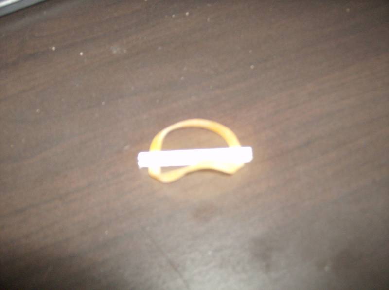

I have a question about the antenna - since my Rx is towards the trailing edge of the wing, the antenna will extend about 16" beyond the tail and I don't want to coil it. Looking at the bottom of the plane, if I exit the antenna out the left side just past the wing, run it down to the tail and bring it back to the right side, will that inhibit my range? See any problems with this idea, besides possibly catching on grass?
Or any other options?

The only thing you want to avoid with the longer antennas is doubling it up on itself. This will reduce the range of the radio and cause problems.

Thanks Ken - It would be more of a V shape following the lines of the fuse on the bottom. So, yes it may impact the range.....I'll see if I can re-route like you have in the picture, following the inside of the radio compartment and then exit the plane.
