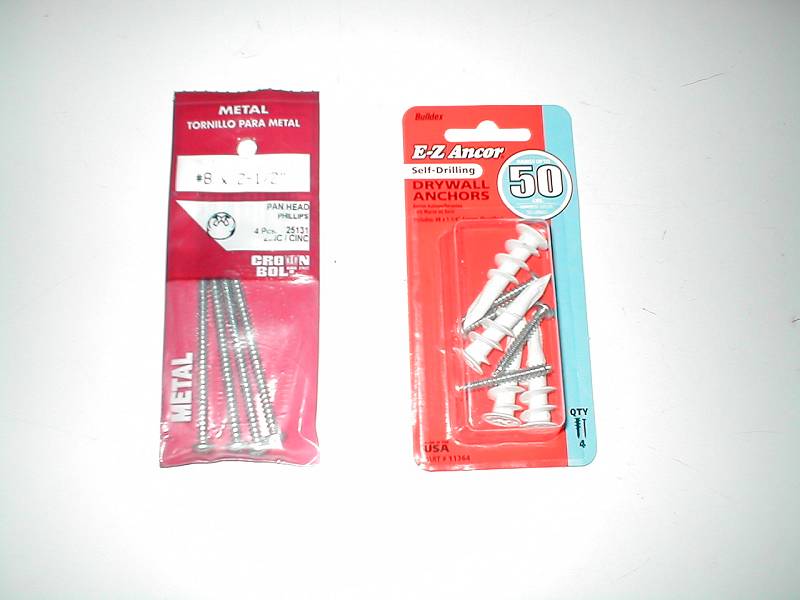

i just built me a cheap one today for a test....used 7/16 dowel rods....might go to 1/2 inch or larger on the rods but the 7/16 rod will work for now. just drilled holes 7/16 in the 2x4's and shoved the rods in. secured the 2x4's into the drywall with screws and the anchor in 2 places on each 2x4.
pic attached are the anchors that go into the drywall (short screws that came with the anchors weren't long enough) so I bought #8 2 1/2 inch screws
the metal brackets are much more expensive

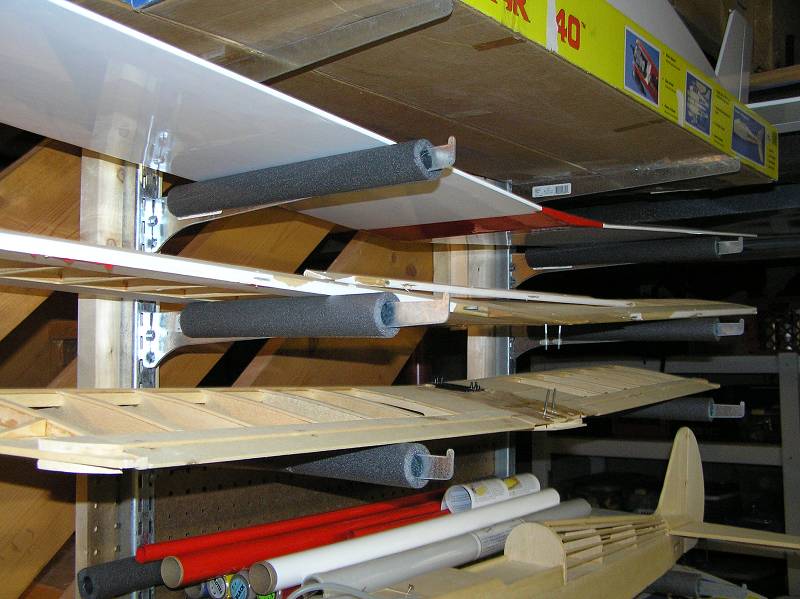

The most "affordable" solution I found was at Home Depot. Go to the shelving section and get the steel (gray colored) standards with the 16" supports (the ones that look like blades, not the big ones you can park a truck on). Then head down to plumbing and buy a couple strips of pipe insulation.

Old 01-14-2008 | 09:55 PM
My Feedback: (494)
Joined: May 2004
Posts: 1,437
From: Palm Bay, FL
Default RE: need a rack to store planes!

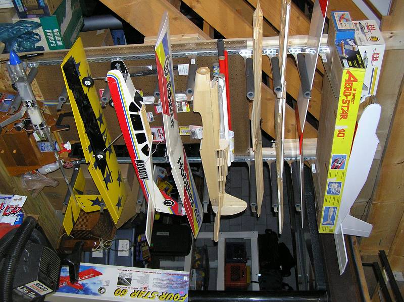

If you have a lot of planes, you can really cram them in there too. This is just basic utility shelves from walmart. I pack them in two a rack. Insulation for hot water pipes protects the covering. I still run out of room, hence the 272 ratings on the marketplace here.

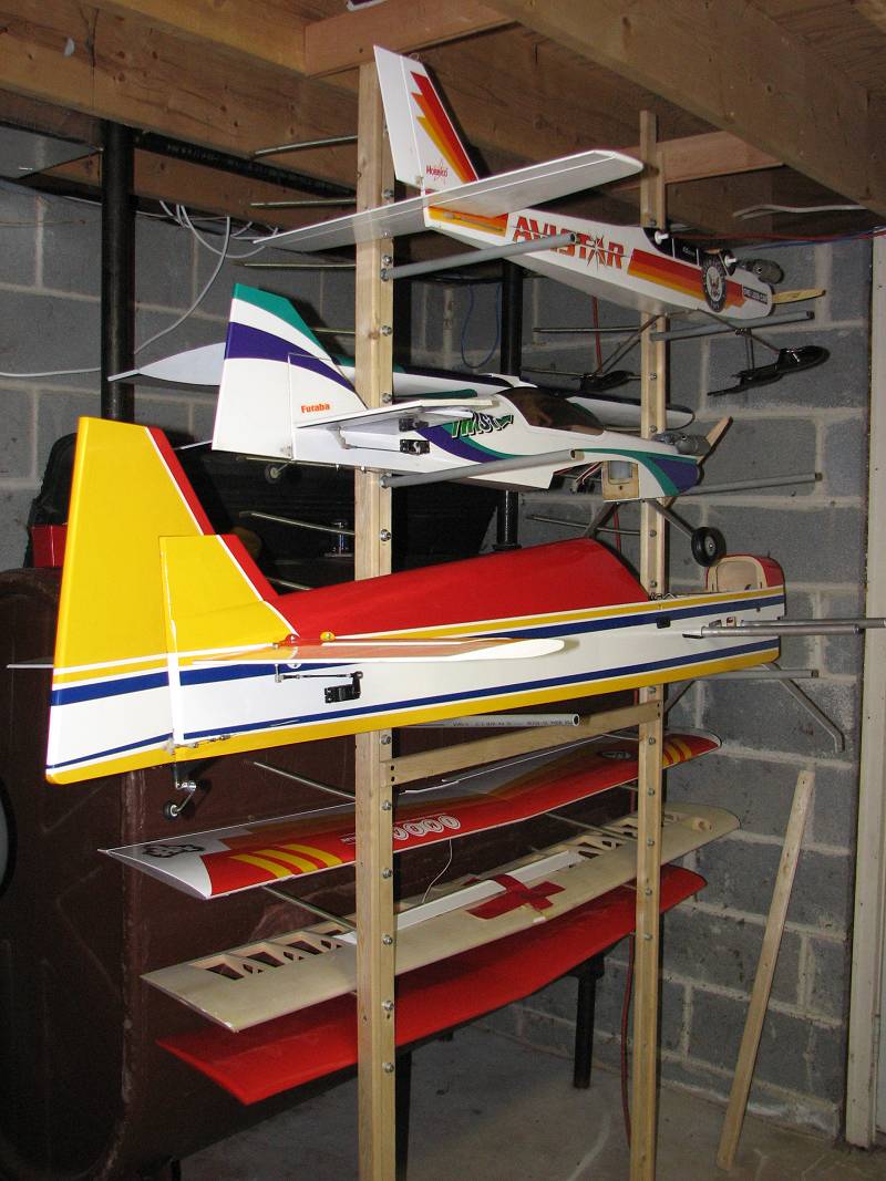

Old 01-15-2008 | 08:06 PM
acarter's Avatar
Joined: Nov 2006
Posts: 927
From: schuylkill haven, PA
Here's my setup!
Old 01-16-2008 | 03:54 PM
Joined: Feb 2003
Posts: 1,555
From: Lake County, CA
Kit,
Thanks for the idea of not putting those shelves on a wall.
I never liked that setup for planes because of the horiz stab.
I have a perfect place to put a similar setup in my garage.
Again, Thanks!

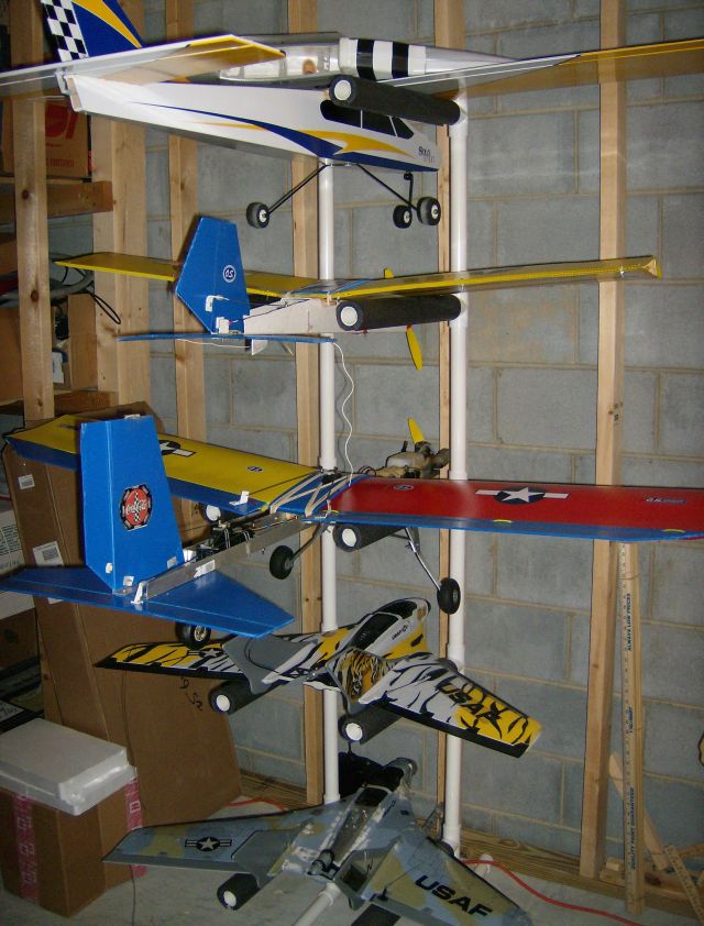

Posts: 47
From: North Central, NC
Very cheap, and effective. Just PVC pipe and pipe insulation all from Lowes. Depending on weight of your planes, you can use smaller sizes than I used. Just standard plumbing pipe, and I did not glue them together. Makes it easy to move or re-arrange if you change things later.
