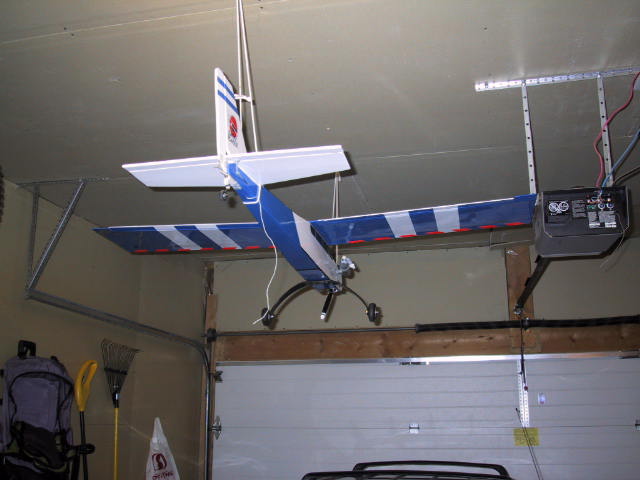

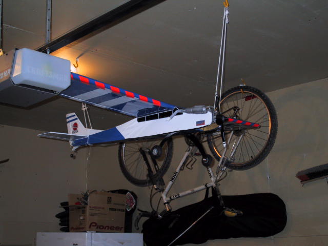

Here are a couple pics of the PT40, hanging in my garage. Note the tail wheel.
ID:	112903   Click image for larger version
