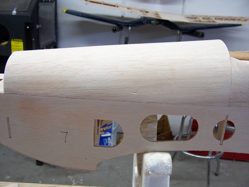

Pics are of my SlowPoke .40 . The sheets were edge glued with Elmers and then sprayed with water and wrapped around the fuse to fit, cut and glued in place with CA+.

I used your suggestions last night and while my sheeting doesn't look near as perfect as Insanemoondoggie's in post #19, I am happy with the results. Many thanks to all who helped!

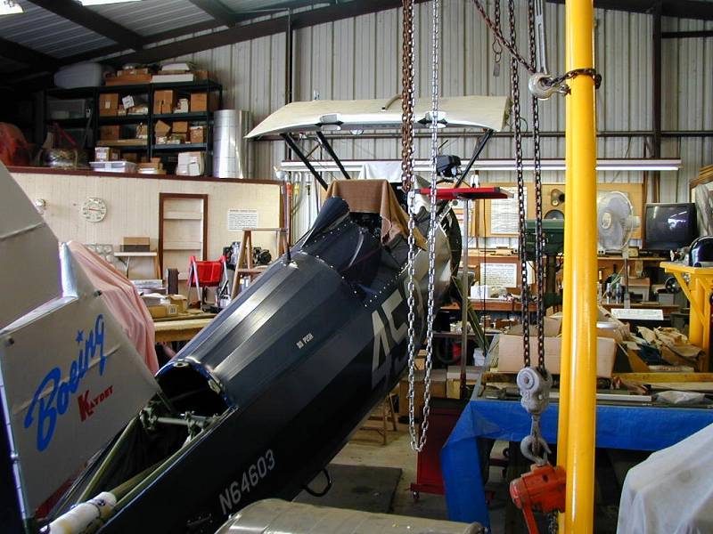

Maybe, but I bet your garage is cleaner.
Old 02-08-2008 | 02:05 PM
H5487's Avatar
Joined: Dec 2005
Posts: 1,088
From: Houston, TX
Default RE: Bending balsa with ammonia water?
Don't bet on it! []
Harvey
