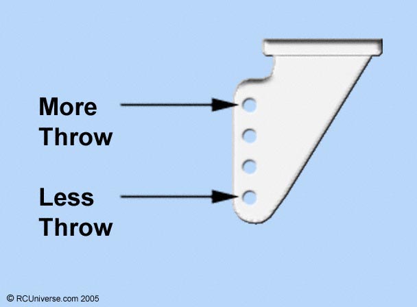

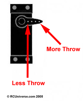

Hi guys, I need some help hooking up my throttle control rod. I have a super tiger 40 ringed engine. when I hook up the control rod to the engine and then adjust it to the servo, it closes the carb like it should but to give it throttle ( to open the carb) it only opens a little over half maybe 3/4. I've looked and tried everything I can think and can not make it open all the way up with out it changeing the carb at the closed setting. I'm new to setting one up and cant seem to figure it out. The transmitter is a Hi Tech 4 ch. with standard servos, not sure of the #'s on the servos. I hope some one can help me. thanks for all the info you can give..

start out centered and play with it from there........it can be done as we had no choice back in the 60's and early 70's..........all our linakgaes were set manually............
Since you are short on "throw" start with the pushrod connected to the far outside hole of the servo arm and whatever point you presently have it at on the engine arm. If this still isn't enough total throw you either need a longer servo arm or to move the throttle arm attachment closer to it's pivot point. This is actually the proceedure you will need to adapt for ALL of the controls surfaces as well.
