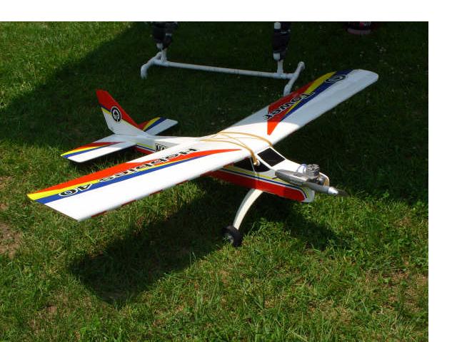

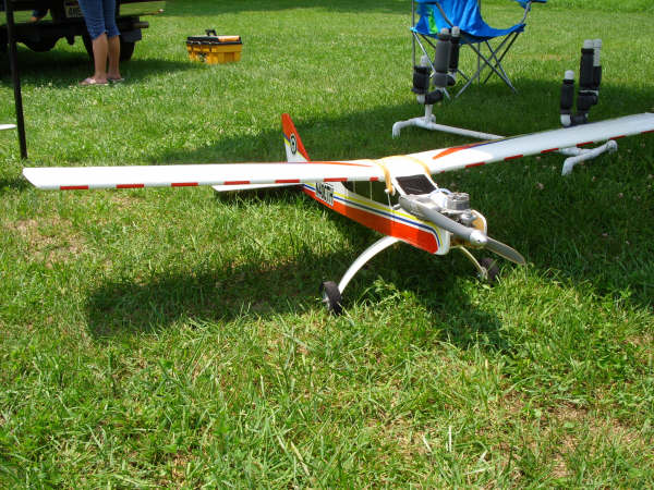

I just converted mine into a taildragger. After a few "not so perfect landings" the nose gear gets bent. Where it's bent is weak and will bend even easier the next time. My next plane is A H9 Ultra-Stick, which is a taildragger, so this should help me get ready for that plane. It's a little different on take off, but I like it.

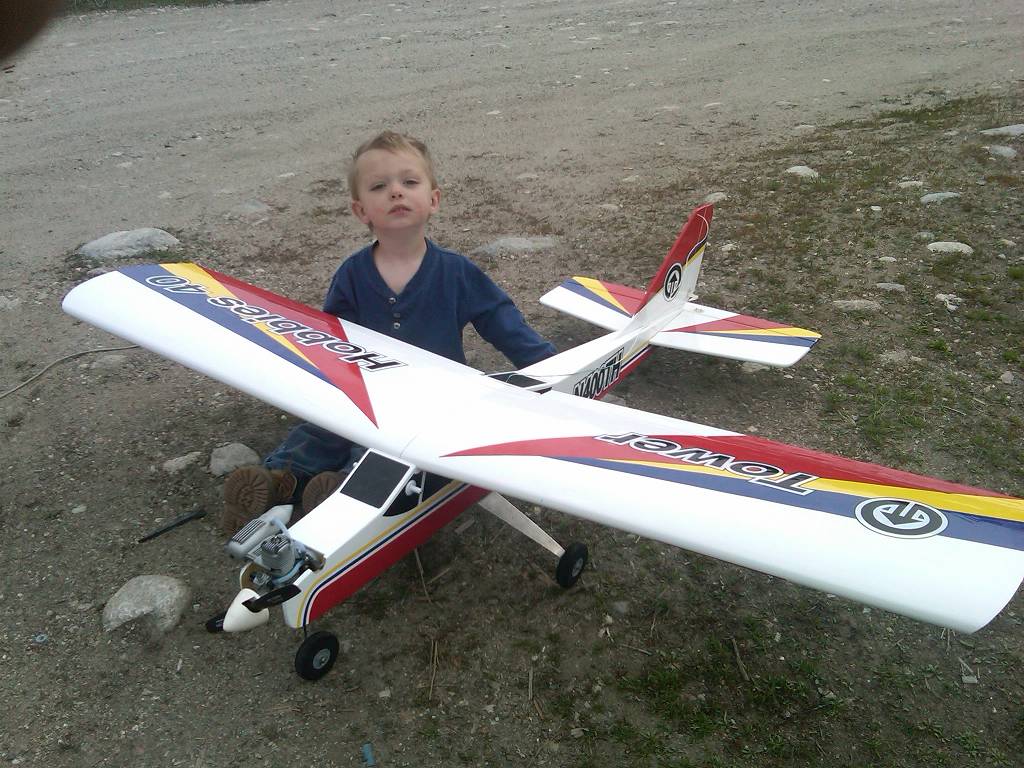

ya i agree i have had mine for a mounth and the landing gear was the firdt thang to go. i also orderd a 6 channel radio by tower i modifide the wing so i can put flaps on it to try to help with the landings i have a os la 40 on mine and its just hals ass on the landing what u think will it help. and i have triad rolls with with it and thay look like crap. do u think its cusze i dont have enouph throw in the allerons? ..........west
