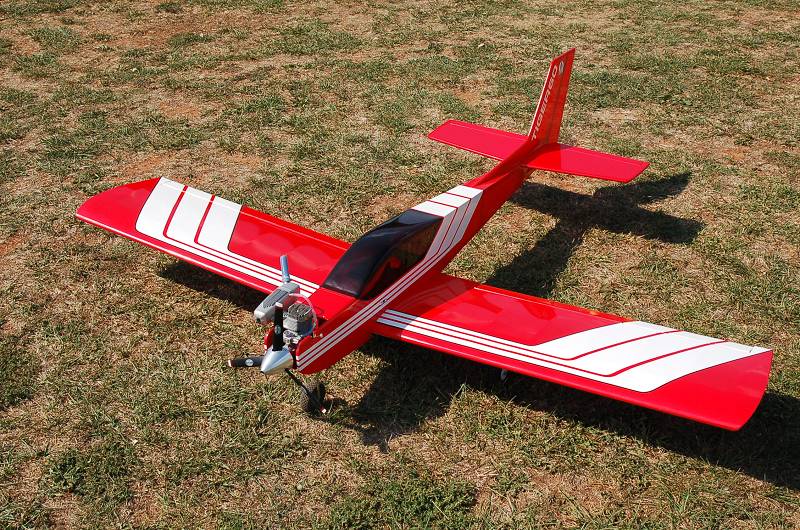

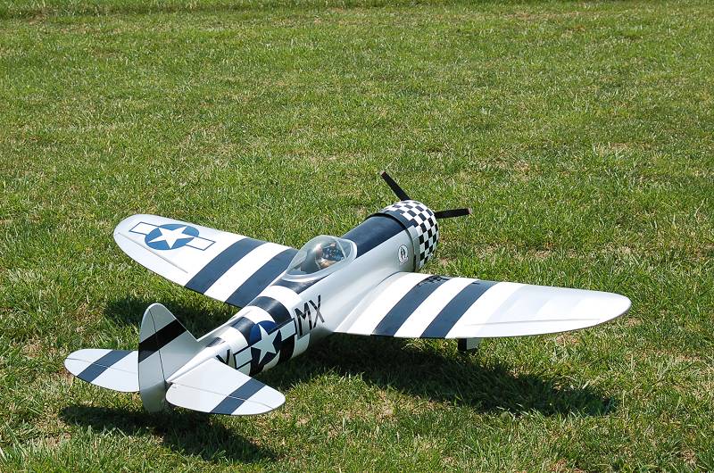

I fly 3 different airplanes with 3bladed props. One flies just a good with a 3 as a 2. It's the P47 and I'm not looking for excellent performance, just good enough performance. The 3blade does better than just good enough. But that 3blade isn't better than the 2blades, unfortunately. But I'm fortunate that there is a suitable 3blade manufactured.
The Skybolt works extremely well with the 3blade shown. That 3blade is one of the top performing props for that engine/model combination. About 3 different props work equally well, and better than all the rest of the props. And the 3blade is one of those 3. The airplane is an excellent aerobatic model. And nothing about the 3blade prop causes any lessened performance. That 3blade shown in the picture is as good as the 2blade props that performed "best".
The Tiger60 with it's 75AX are standout performers. And the best performing prop that I've found for the combination is the 3blade shown in the picture of that red Tiger. The model is the one I choose to fly most often. And it's partly because of the extra performance that specific prop helps to provide.
I wish there was more selection available in 3bladed props. But they cost more and that reduces sales. And too many "expert" modelers, most of whom have little or no experience with 3's, repeat the "wisdom" they heard from somebody else about 3blades. And it's wrong.
There are two disadvantages that matter. There isn't enough selection, and they're more expensive.

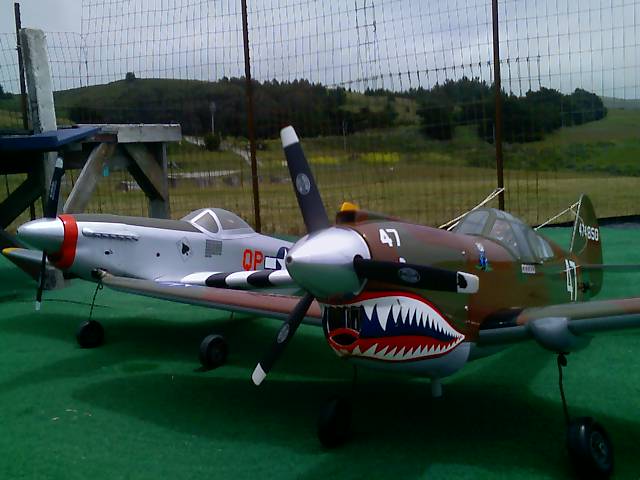

what I have found is a 14/7 3blade is a good size for a 91 4stroke for warbirds,I can get 9,200rpm without bogging the engine down, when I went higher in pitch such as a 14/9 the engine was bogging down with the extra drag,if your looking for performance then a 13/7 is a good choice just a little less drag but still getting the bite if the 7pitch prop since your engine isn't a high reving one being a 4stroke it can handle the higher pitch props.
both of these planes have OS91 surpass engines in them

3 bladed props go great with some planes, especially the above P-40.
