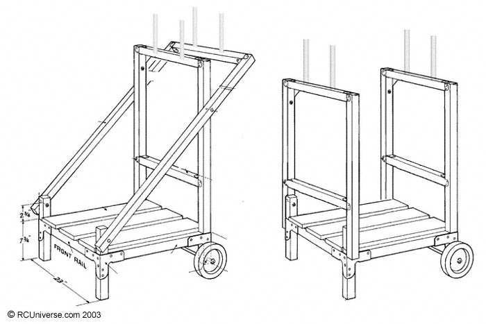

Here's something interesting I found:
Old 04-22-2003 | 04:09 PM
MinnFlyer's Avatar
Posts: 28,519
Received 9 Likes on 9 Posts
From: Willmar, MN
Default Flight box on wheels?

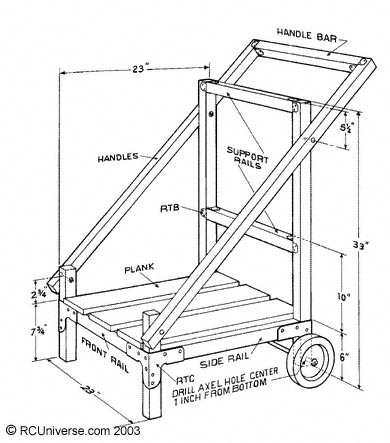

It could be modified to something like these:

What'd I tell y'all? I WAS lucky!
I'm thinkin' that my old golf bag cart may be minus its wheels here directly!
