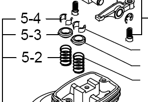

Well, what do you know, I removed the valve cover and found I have a broken valve spring. Now my question is just how do you remove it? I removed the rockers and now it looks like it has a retainer on top of the spring, but how do you remove it. It didn't look like it had a "C" ring/clip on top of the retainer to hold it on. Did I just miss seeing it or what? Also when I replace the valve spring shoould I also order new retainers and/or "C" ring/clip (if any) at the same time. Thanks for all the help.
Old 03-16-2008 | 05:34 PM
Missileman's Avatar
Joined: Feb 2006
Posts: 3,204
From: Poland, OH
Default RE: O.S. 91SII problems
Page 24
http://manuals.hobbico.com/osm/fs91-ii-fi-manual.pdf
Looks like springs, retainer, split cotter.(split collet according to the part number)

Part Numbers
Stock Number / Mfr Number / Product Description
OSMG9242 45960200 O.S. Valve Spring FS-91Surpass
OSMG9231 45960300 O.S. Valve Spring Retainer FS-91Surpass
OSMG9227 45960400 O.S. Valve Collet FS-91 Surpass

Thanks for the info., I see the parts that I need now. So I went back to the shop to take another look and I see the parts, but how do they come off. I do not see how to get the valve spring retainer and/or the split cotter out to be able to remove the spring. Do I need a special tool for this? Or do I need to remove the head and pull it all out from the bottom side? I'm sure it is not as hard as I am making it, but I have never done it before and i would rather do it right than just guess and cause further damage. Thanks.
Old 03-16-2008 | 07:30 PM
Joined: Apr 2003
Posts: 643
From: Flower Mound, TX
Take off the head and find a round piece of broom handle to sit the head on. That will hold the valves closed. I used needle nose pliers to depress the springs and a pin and tweesers to remove and install the collets and keeper that retains the spring. I use a baking/cooking bag to keep the little collets from getting lost.

Just to let you guys know I got my new valve spring in from tower last night and just got done getting it put back together. That is one of those jobs that is easy, but a real pain.
It runs great and I am thinking you guys for your input. You nailed it on the head what the problem was.
