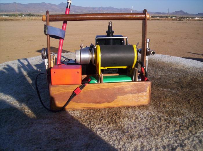

No you are not kidding yourself, going completely portable is quite practical and preferable for many of us. This includes starters and fuel pumps. In the case of the pocket ignitors, most will carry two as a matter of SOP. Most pocket ignitors come with a 1300 mah Nicd and you can also get 2600 Nimh cell to put in the replacable types.

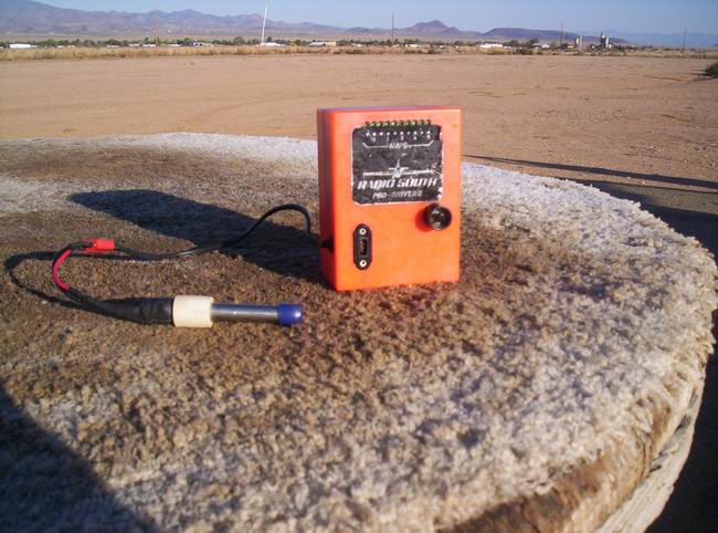

Another popular item for ignition with fans of going portable are the portable glow drivers, my older one has a four cell pack internal and provides automatic instant variable current to the plug for clearing floods without destroying the plug.

Radio South makes a pretty nice glow driver. It has LED's that show if you are connected and, after gaining some experience with it, you can tell the condition of your glow plug by the number of LED's that are lit. But the most important thing is that it shuts itself down when disconnected. You hook it up, push the button, watch the LED's. If glowing, start your engine. When you disconnect it, it, well, disconnects. (they all do this, I know.. but this is one that shows you what's going on rather than one that you don't know until you try to start).
Anyway, it has an internal NiCd battery pack (as most of them do) but with a pretty good capacity. I recharge mine about every third time out to the field, and use it "all day" starting perhaps 5 or 6 times.
