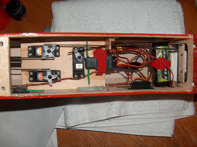

I finished the Skylark 70 tonite. I needed to pick up a CG machine because I broke the one I had.. the LHS had a two of them in stock so I picked one up and set the CG.
It took 7 1/4 ounces of nose weight. I was hoping that it wouldn't need much, but, well, I guess that's not bad compared to the Tiger 120 I built a while back that needed over a pound!!!
So, all I need is some nice weather and I can maiden that baby. It came out nice, by the way.

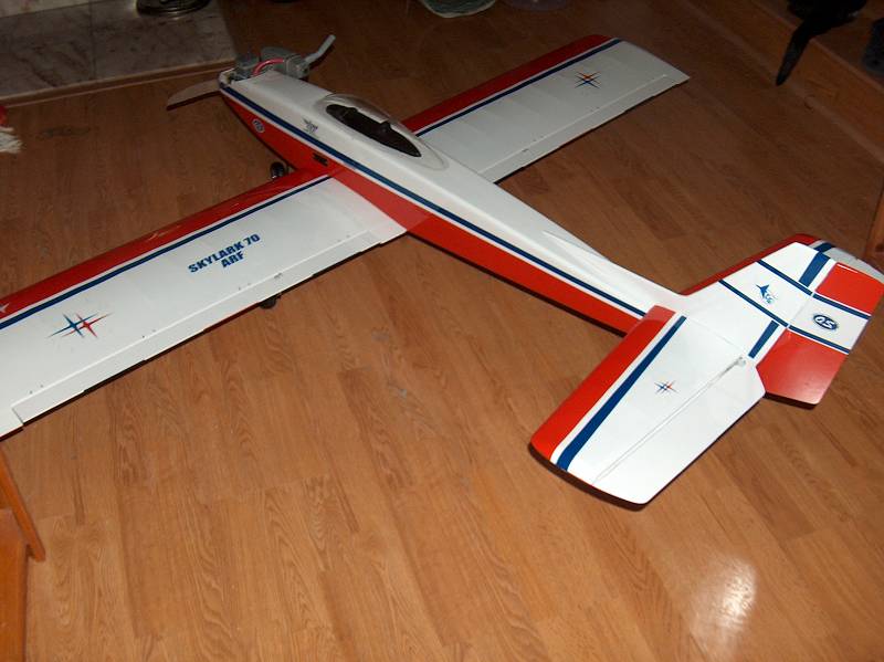

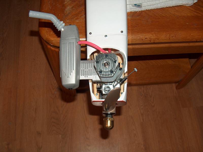

Skylark 70 pictures

If you put that battery pack against the firewall you'd need less nose weight
Old 03-18-2008 | 08:44 PM
CGRetired's Avatar
Joined: Sep 2004
Posts: 8,999
From: Galloway, NJ
Default RE: Skylark 70 done
Well, Mike, I looked at that. I had to modify the tank compatment to get the tank to fit under the hatch cover, then I added a little plywood platform with foam to mount the tank to. When I was done, there wasn't a lot of room to move around up there. So, I put the battery where it was and hoped that I wouldn't need any more weight.
I can live with 7.25 ounces, I guess.. It is a clean install.
CGr.

A pretty nice looking plane, I must admit! I've always liked the Skylarks.
CGr.
