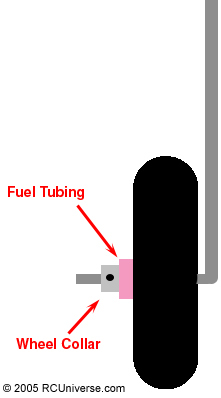

Put a very short piece of fuel tubing on the axle to rub on the side of the wheel. Less damage to the wheel and makes drag adjustable easily.

ORIGINAL: bruce88123
I think this was the same idea behind the loop velcro brake. No stress or hard wearing on parts.
