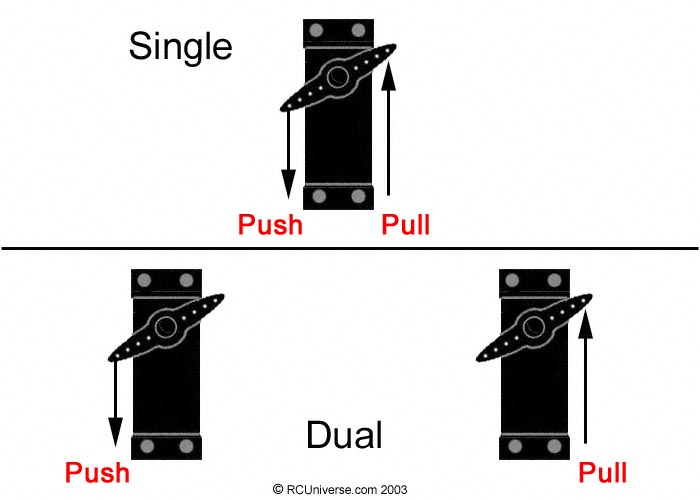

Yes, great. Thanks! One more quetion, though. When using a Y-harness, how does the reciever know to make one aileron go one way, and the other the other way? I'm probably missing some very simple explantion here, but I' m asking it anyway. Thanks again! I really appreciate all of your help.

When you hook up two servos with a Y-harness both servos move the same direction. So if you picture (see attached diagram) the setup on a single aileron servo you will see that one aileron is attached to each side of the servo control arm. When one side goes up the other side goes down, and vice versa. Now move to two aileron servos. Remember that they will move in the same direction. When you hook up your aileron pushrods they will be hooked up identically (both on the outside of the servo, or both on the inside of the servo). So when both servos move one side will still go up and the other side will still go down.
Hope this helps

And that's the obvious solution I was thinking of! Thanks again.
