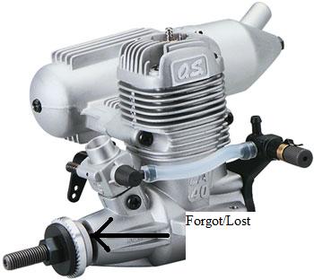

Thank you for your input. One more question. When changing the prop on my O.S. 40 LA, I inadvertantly took off the backplate. Well, I put it back on, but it is not on evenly, or it is bent. When I am at idle, it is clanking against the engine. When I move beyond idle to higher rpms, it no longer clanks. How can I get the backplate off? It's being difficult.
#29
Did you forget the washer under the prop drive?
If you lost or forgot it, the crankshaft will slide too far back as you tighten the prop nut and cause the rear of the shaft to hit the backplate ( why doesn't O.S. fix this? )...
As for the backplate...
Remove the four screws and lightly wedge a screwdriver in to gently pry it off.

Yes, you really need it.
You can get another from Tower or maybe your local hobby shop if they stock OS parts.
It''s a really thin washer, so I don''t know if there would be problems with just finding or making some other washer that fit. Too much space would make it easy for dirt to get in there, and might cause problems with the prop hub''s fit on the crankshaft.
