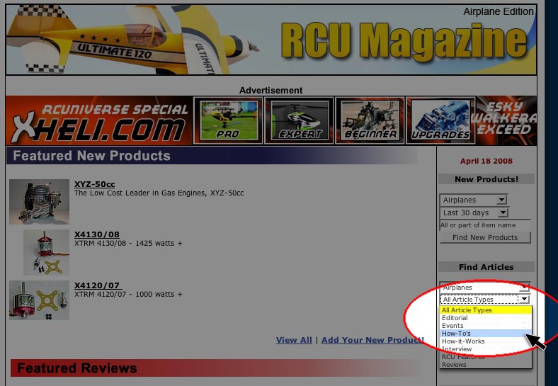

That's weird, must be a bug in the new system.
Click the Magazine tab at the top - Go to "Search Articles" and select "How-To's"
Then go to Page 2 - it's the very last one
