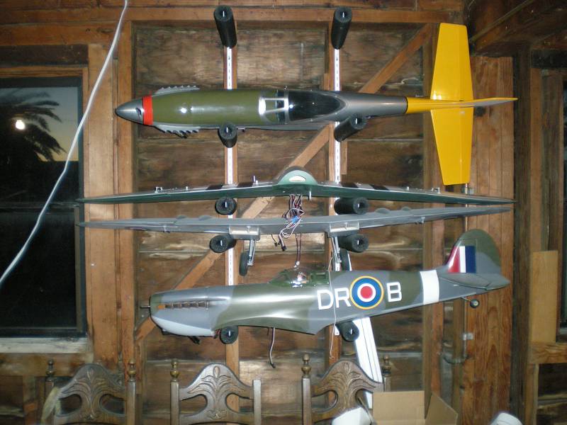

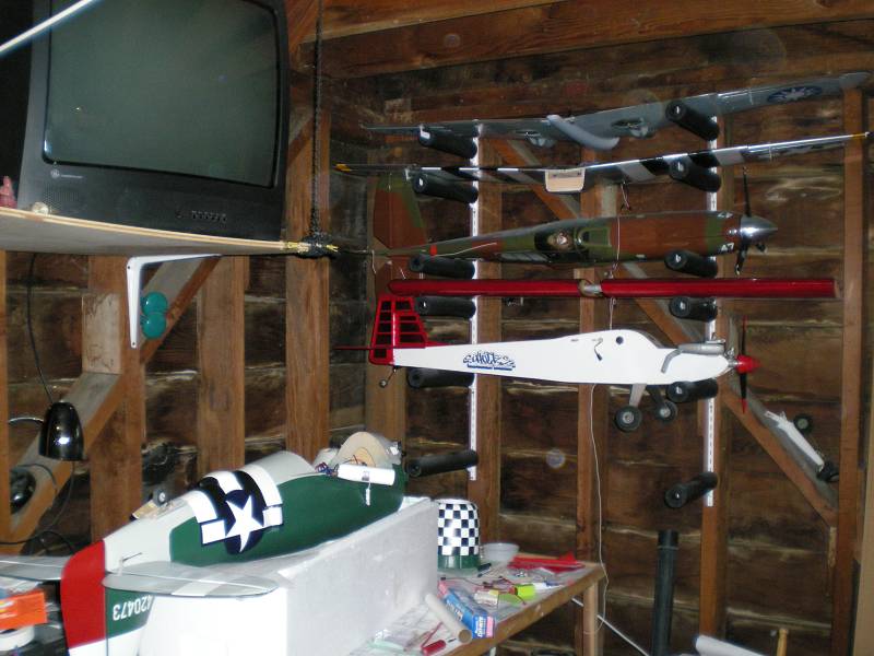

looks like a good set up,like the peg board wish I had some in my shop, if I was to do anything different I would pad the hangars so they don't dig into the rear stab,I would worry about fatigue in the wood and connection at the elevator over time,never can hurt to pad any metal hangar.
here's what I did with shelf brackets and some pipe insulation.
ID:	931763   Click image for larger version

Wow, I stopped by the Home Depot after work today to design the exact same setup in my spare bedroom it just seemed like the best way to do it…[sm=idea.gif]
But I’m thinking about building some type of rack transport system for my SUV… maybe using PVC pipe????
Any Ideas???
God Bless and happy landings,
Stuart
Old 04-18-2008 | 12:15 AM
My Feedback: (13)
Joined: May 2004
Posts: 4,177
From: san francisco, CA
Default RE: Hanging Glow Planes vertically BAD!?
there is a bunch of info on PVC airplane racks do a search and you will find several threads on the subject.
Home Depot is where I got all the shelf parts for my rack,the pipe insulation holds onto the brackets pretty tightly,and doesn't pull off at all.

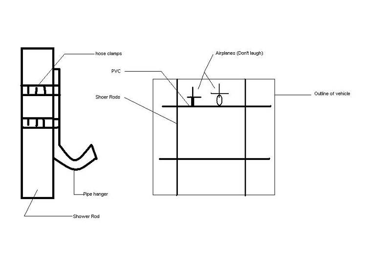

ORIGINAL: dive2277
Here's an idea I came up with 2 years ago for the wife's van, and have duplicated in my new Kia Sportage:
Go to any hardware/home goods store, and pick up some shower rods. I've found the screw-type (the ones where you screw in or out the one end to set the length) work a bit better, but the spring-type will work as well. You'll need at least 4 of them.
Then run to the plumbing section, and get some sort of pipe hangers. They're shaped like a J usually, though other types will work. http://www.lowes.com/lowes/lkn?actio...5216&lpagenone is an example at Lowe's. You'll want one of these per shower-rod for each "level" of rack you plan to build. (So, if you want to have 2 levels, you'll need 8 of them...hope that made sense)
You'll then want some hose clamps...two for each pipe hanger.
And finally, some PVC pipe to use as the "racks" themselves.
Using the hose-clamps, attach the pipe-hangers to the shower-rods.
Then, place the rods in the SUV/Van running floor to ceiling, using whatever adjustment method the rods have to make sure they're good and sturdy.
Finally, place the PVC in the pipe hangers, running side to side (horizontally in the vehicle, in other words). Have one in the rear, another up front, and others in the middle if needed, depending on plane size/weight.
Poof. Airplane transport rack system. It's cheap, requires no more tools than a screwdriver, and can be easily and quickly removed from the vehicle, without modifying the interior in any way. You can slide large gassers under the bottom rack, and then run other planes on the racks themselves. With a little creativity and some extra rods, you can even have a wing rack on one side.
Using this method, I can transport:
1/3rd scale Pitts Bulldog
Giant Aeromaster
.40 sized Super stick
GWS Slow Stick
Funtana .90
All in a Kia Sportage. Granted, there's no room for a passenger in that scenario, but that's a whole bunch of airplane in such a small vehicle.
Here's a quick and dirty drawing of the concept (VERY quick and dirty....don't laugh *heh*). I'll drag my system out and install it this afternoon when I get home from work, and post some pictures.
