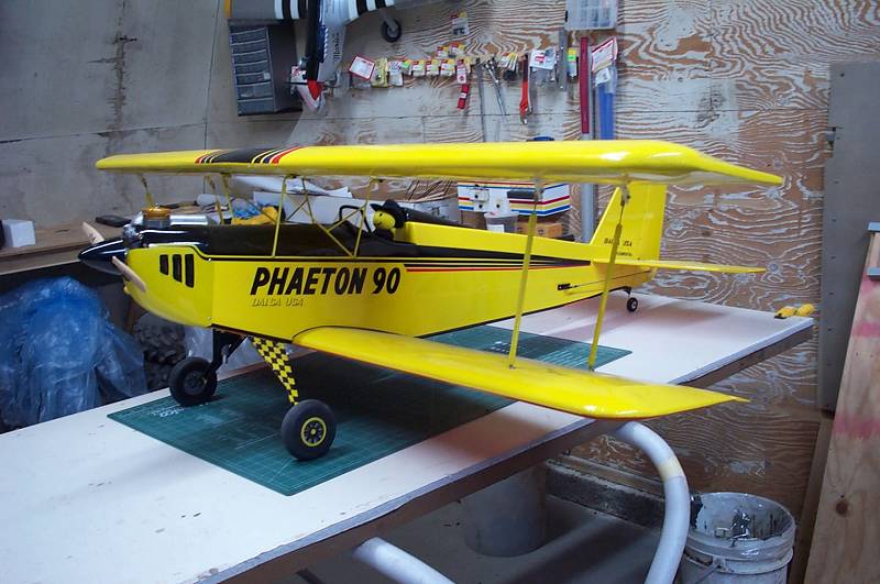

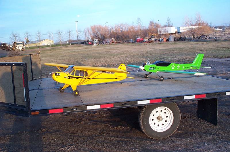

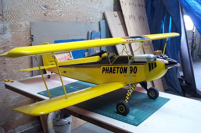

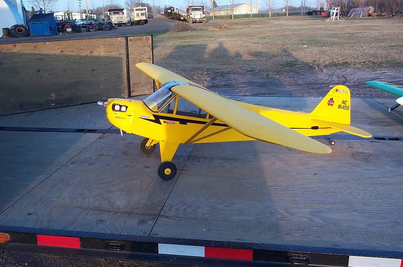

My Balsa USA Phaeton 90 Bipe flies and lands every bit as nice if not better than my GP Cub. It just floats in nice and slow with a little power on and slightly nose down for landings. Very, very nice landing plane.
