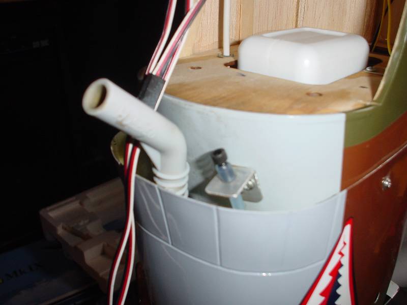

The fuel tank on my plane has three lines. One to the carb, one to the muffler, and one to fill. The tank is completely hidden from view. My question is, how do you know when the tank if full of fuel, other than waiting to see it coming out of the muffler! This obviously floods the engine every time. Is there a better way? By the way, the lines are hidden behind a cowling, so it's not possible to easily disconnect the line to the muffler.

since the muffler is hidden in the cowl of my Hangar-9 P-40 I used a small nylon T fitting,I got it from the local Ace hardware, to make a alternative vent line off the muffler pressure line, when I fill the tank I pull out some of the slack, and pull the plug on the line,placing it in a small cup to catch the fuel.
then when I fill I either hold my finger over the muffler end or I have a little plug that fits the rubber diverter,works great.
the aluminum bracket is drilled so the fuel line slides freely,but the allen head screw wont slip through.

you put the T fitting on the pressure line inbetween the fuel tank and muffler,then when your filling just plug the exhaust holes on your pits muffler the overflow will go out of the open line out of the bottom to your catch container.
I am going to start using a extra tank I have thats a good idea(alfredbmor).
then replace the plug in the overflow and unplug the muffler,or just take your fingers off the exhaust tubes and there you go, by plugging the muffler holes the fuel will be diverted to the overflow line and not to the muffler canister,on the photo I posted the line is just inside the cooling fins so its out of site but easy to grab and pull out enough slack to drain into a cup,when I am finished fueling, I just plug it and slide the fuel line back in,its pretty easy and takes little time at all.
the nylon T I used has barbs so the fuel/pressure line won't slip off as well.
